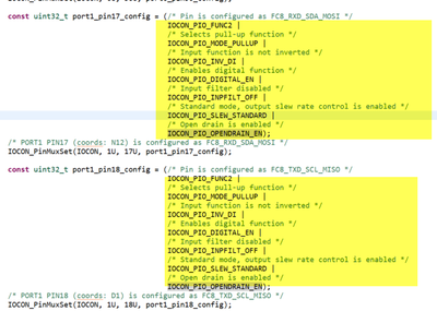

    Thanks for the reply. We tried the SDK I2C example on our customized board (208 PINs). Even after enabling the open drain (IOCON_PIO_OPENDRAIN_EN), still we're not getting the clock signal. Hereby I have attached the code and screenshots of debug results for your reference.
We're using a pull-up resistor (1.8kohm) in EEPROM IC (24LC512). Is there any suggestion for using the pull-up resistor?
SDK example code:
/* attach 12 MHz clock to FLEXCOMM8 (I2C master) */
CLOCK_AttachClk(kFRO12M_to_FLEXCOMM8);
/* reset FLEXCOMM for I2C */
RESET_PeripheralReset(kFC8_RST_SHIFT_RSTn);
BOARD_InitPins();
BOARD_BootClockPLL180M();
PIN configurations:
const uint32_t port1_pin17_config = (/* Pin is configured as FC8_RXD_SDA_MOSI */
IOCON_PIO_FUNC2 |
/* Selects pull-up function */
IOCON_PIO_MODE_PULLUP |
/* Input function is not inverted */
IOCON_PIO_INV_DI |
/* Enables digital function */
IOCON_PIO_DIGITAL_EN |
/* Input filter disabled */
IOCON_PIO_INPFILT_OFF |
/* Standard mode, output slew rate control is enabled */
IOCON_PIO_SLEW_STANDARD |
/* Open drain is enabled */
IOCON_PIO_OPENDRAIN_EN);
/* PORT1 PIN17 (coords: 98) is configured as FC8_RXD_SDA_MOSI */
IOCON_PinMuxSet(IOCON, 1U, 17U, port1_pin17_config);
const uint32_t port1_pin18_config = (/* Pin is configured as FC8_TXD_SCL_MISO */
IOCON_PIO_FUNC2 |
IOCON_PIO_INV_DI |
/* PORT1 PIN18 (coords: 15) is configured as FC8_TXD_SCL_MISO */
IOCON_PinMuxSet(IOCON, 1U, 18U, port1_pin18_config);

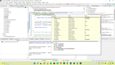

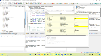

Screenshots of debug results

After changing the flexcomm 0 to 4, there we checked the SDA and SCL pins by configuring it as GPIO, it gets toggled. And then we used it for I2C communication. Still we didn't got the clock signal.
How can we confirm that the clock configured for the specified flexcomm. Is there any way for that?
While debugging the code, we're the flexcomm shows the master idle after sending the slave address and start condition, it becomes master busy.
