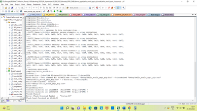

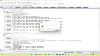

    I tried to download 1MB program on winbond W25Q128JVFM external flash through LPC54018 microcontroller using ULINK2 debugger (Platform: Keil microvision IDE). But the debugger failed to download the code with "Erase failed" or "Erase done. Programming failed" or "Content mismatch error" such error messages. Here i have attached xip_debug.ini file and linker script file for reference.

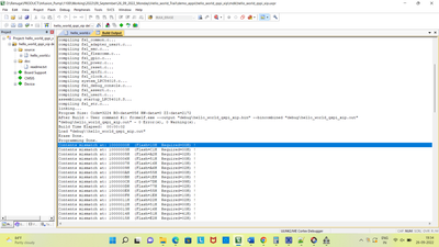

    In our customized LPC54018 board (208 pins), upto 500kb we're able to flash program using the default FLM file provided by keil uvision software tool. But while trying to flash more than 500 kb, it shows "Contents mismatch at: 10000000H (Flash=10H Required=00H) !" error and verification failed. Also i tried the same with LPC54018 EVK board (180 pins), it works on both MCUxpresso and keil uvision tool by using a ULINK2 debugger toolchain.
Is any possibilities on changes in configuration of FLM file from LPC54018 (180 to 208 pins)?

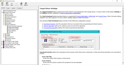

Thanks for the replay. Even though, "Programming Algorithms" for LPC54018 W25Q128JVFM added by the steps provided in the "Help->uVision Help". Still we cannot flash the programming of 16MBytes. I have added the screen shots for your reference. As well as, I cannot find the “FlashDev.c” and “FlashPrg.c” files for the programming algorithm "LPC540xx W25Q128JVFM SPIFI" (Default file given by keil uvision). Can you help us for this?
6,732 Views
xiangjun_rong
After you launch the Keil tools, pls click the "Help->uVision Help", you will get the image.
Then click the "Programming Algorithms", and select the corresponding Flash Programming Algorithms for the LPC54018 W25Q128JVFM .
Hope it can help you

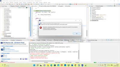

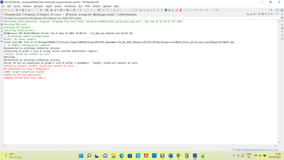

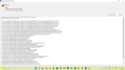

    We have tried another way to flash download the 5MB code on LPC54018-EVK board using MCUxpresso tool through ULINK2. It works fine. But in our customized 208 pin board, it showed "unable to connect wire for probe index 1" & "Error: Wire ACK fault - target connected?". I have attached the screenshots for your reference. For our customised 208 pin LPC54018 board, is LPC540xx_SPIFI_SFDP.cfx file or LPC540xx_part.xml file needed any changes in the configuration? (or) is there any FLM file in MCUxpresso for flashing the code on LPC54018 board.

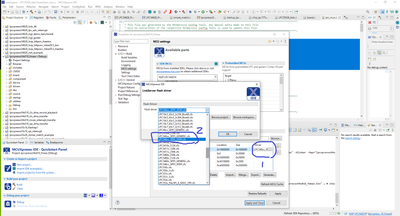

xiangjun_rong
Pls refer to the following figure, try to use LPC540xx_SPIFI_GENERIC.cfx to download code.
On MCUXpresso tools, you can click Project->Properties->MCU Setting, you will see the LinkServer Flash driver menu.
XiangJun Rong
6,664 Views
Renuga_AKAS
    Thanks for the solution. We're able to flash 16MB program on external NOR flash (W25Q128JVFM) through MCUXpresso tool (using ULINK2) with the help of LPC54xx_SPIFI_GENERIC.cfx file.

    We also tried to create a FLM file by following the flash programming algorithm creation steps provided by keil. Still we're getting content mismatched error and a "verification failed" error. Attached a the screenshots of the error message and also our "FlashDev.c" and "FlashPrg.c" code. Is there any other way to download 16MB code on external NOR flash (W25Q128JVFM).
The following images are screenshots of error message:
