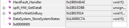

I'm using lpc open SPIFI library (Latest version 1.01) on LPC4357 and S25Fl164K external flash.
I'm using spi flash as an external flash with simple command (Not memory mapped or for running firmware from it)
my problem is that in some cases (specially when erasing a sector by spifiDevEraseSubBlock function) the system throw hard fault
the hard fault rise at the following function:
function "spifi_HW_GetData8" in this code
static uint32_t spifiDeviceDataGetStatusS25FL164K(const SPIFI_HANDLE_T *pHandle)
    static const uint8_t spifiCmdOp[3] = {CMD_05_RDSR1, CMD_35_RDSR2, CMD_33_RDSR3};
    uint32_t statusRegs = 0;
    LPC_SPIFI_CHIPHW_T *pSpifiCtrlAddr = (LPC_SPIFI_CHIPHW_T *) pHandle->pInfoData->spifiCtrlAddr;
    uint32_t idx;
    for (idx = 0; idx < sizeof(spifiCmdOp) / sizeof(spifiCmdOp[0]); ++idx) {
        spifi_HW_SetCmd(pSpifiCtrlAddr,
                        (SPIFI_CMD_OPCODE(spifiCmdOp[idx]) |
                         SPIFI_CMD_DATALEN(1) |
                         SPIFI_CMD_FIELDFORM(SPIFI_FIELDFORM_ALL_SERIAL) |
                         SPIFI_CMD_FRAMEFORM(SPIFI_FRAMEFORM_OP)));
        statusRegs |= (spifi_HW_GetData8(pSpifiCtrlAddr) << (8 * idx));
        /* Wait for command to complete */
        spifi_HW_WaitCMD(pSpifiCtrlAddr);
    return statusRegs;
Call stack:
what is wrong with my system or spifi configuration?

Hi Dolphin,
I would recommend you to test and compare the lpcspifilib example that comes with LPCOpen with your project:
LPCOpen Software for LPC43XX|NXP
Hope it helps!
