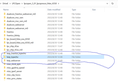

First of all, pls download the firmware package from the LPCopen
https://www.nxp.com/design/microcontrollers-developer-resources/lpcopen-libraries-and-examples/lpcop...
The lwip is a standard ethernet stack. For the phy and the on-chip ethernet driver, pls refer to the directory:
....\LPCOpen\lpcopen_3_01_lpcxpresso_hitex_4350\lwip_tcpecho\common
This is the LWIP example:
Hope it can help you
