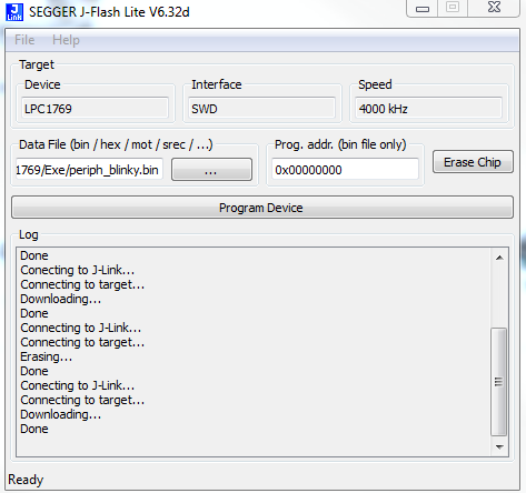

jeremyzhou
Hi Mateus José Barbosa,
Just like Con Verse mentioned, the LPC series MCU hasn't provided the register level access to the internal flash, I hope this is clear.
NXP doesn't provide some application note which guides you to access the flash via the SWD interface.
So I'd like to suggest you capture the waves of SWDIO and SWDCLK pins by the oscilloscope or logic analyzer when erasing or programming the LPC1769 in the J-Flash lite, these waves definitely follow the SWD protocol and you can find the process of erasing or program via analyzing them.
