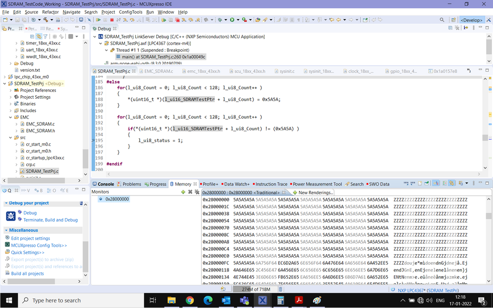

Here you can see the behavior of SDRAM. I have written the below code to test the SDRAM interface. i am able to write some address with fix values correctly. shown above in color line.  But after that Instead of 0xA5A5 it is writing 0xADA5.
What could be the problem? Similarly when i tried with 0x5A5A then it is written properly.
I would first confirm the results in instruction step mode, i.e. the core register written to the SDRAM address really contains 0xA5A5 and the SDRAM cell contains 0xADA5 after the write
Anyway, the difference between 0x5 and 0xD is only one bit (the MSB). There might be a hardware problem (i.e. bit 10 is forcing bit 11). But I would try other pattern before.

I checked the hardware and found one line configuration missing which is D11 to be configured as EMC line in the controller which i did modify and confirm the behavior.
Now the SDRAM test code is working as per the expectation. I will check it by using __DATA and __BSS attributes by allocating the variable in the SDRAM location since there it is not working.
I will reconfirm the same and revert with the result. But till date the test code for SDRAM using pointer variable is working with 2byte configuration. Also find the attached modified code.

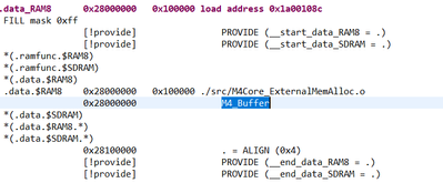

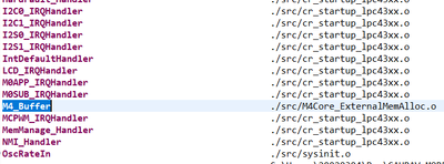

I have checked the MAP file but not able to where it is allocating the space in the flash. Refer the below map file for the attached code. Following are the two different locations in the map where we can see the M4_buffer allocated. Below screen shot shows that it is allocated to SDRAM memory which is intended.
In the below screen show is the other location for M4_Buffer. So it seems there is no such information of the buffer occupying the main flash of M4 core.
Still after compilation it give the below error, refer the screen shot below
