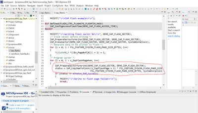

Loïc
I tried to adapt the code of iap_flash (example code of LPC802) with your code but I don't really understand what's happening.
You can tried with the project attach to the message.
But to summurize :
uint32_t *Addresse;
PRINTF("\r\nWriting flash sector %d\r\n", DEMO_IAP_FLASH_SECTOR);
    /* Erase sector before writing */
IAP_PrepareSectorForWrite(DEMO_IAP_FLASH_SECTOR, DEMO_IAP_FLASH_SECTOR);
IAP_EraseSector(DEMO_IAP_FLASH_SECTOR, DEMO_IAP_FLASH_SECTOR, SystemCoreClock);
    /* Generate data to be written to flash */
    for (i = 0; i < FSL_FEATURE_SYSCON_FLASH_PAGE_SIZE_BYTES; i++)
        *(((uint8_t *)(&s_PageBuf[0])) + i) = 5;
        PRINTF("\r\n%d		%d",*(((uint8_t *)(&s_PageBuf[0])) + i),i);
    /* Program sector */
    for (i = 0; i < s_IapFlashPageNum; i++)
        Addresse = (uint32_t*)(((s_IapFlashPage) + i) * FSL_FEATURE_SYSCON_FLASH_PAGE_SIZE_BYTES);
        PRINTF("\r\n%x	%d", *Addresse, Addresse);
        status = IAP_CopyRamToFlash(((s_IapFlashPage) + i) * FSL_FEATURE_SYSCON_FLASH_PAGE_SIZE_BYTES, &s_PageBuf[0], FSL_FEATURE_SYSCON_FLASH_PAGE_SIZE_BYTES, SystemCoreClock);
        PRINTF("\r\n%d	%d	%x", *(((uint8_t *)(&s_PageBuf[0])) + i),
((s_IapFlashPage + i) * FSL_FEATURE_SYSCON_FLASH_PAGE_SIZE_BYTES), *Addresse);   //Trying to display the addresse of the data and the data it self
        //Addresse++;
        if (status != kStatus_IAP_Success)
            PRINTF("\r\nWrite to flash page failed\r\n");
            break;
And when I try to watch with the serial port, i have this output :
Writing flash sector 14
5 0
5 1
5 62
5 63
0 14336
5 14336 5050505
0 14400
5 14400 5050505
0 14464
5 15232 5050505
0 15296
5 15296 5050505
I don't really understand how it is store in the flash. Per apps du to the misunderstanding of the "iap_entry" function.
How this function works ? It's called in the "IAP_CopyRamToFlash" function but How does it work's after the "FSL_FEATURE_SYSCON_IAP_ENTRY_LOCATION" gateway ?
