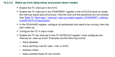

ZhangJennie
Hi frank-lin-Sunon
I2C slave can wake up Power Down mode. We need to make sure I2C interrupt is enabled.

frank-lin-Sunon
I had try using gpio wake up from power-down mode and delay about 10ms to get i2c signal.
It can wake up, but often return nack at address or all 0 bit when master try to read data (never work).
What setting do i have to do to let i2c can wake up mcu in power-down mode?

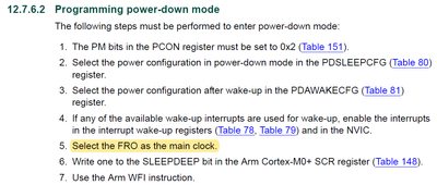

ZhangJennie
Hi frank-lin-Sunon
Please make sure you follow the right process before enter power down mode. especially configure FRO as main clock
besides, please also make sure if you well configure I2C as wake up
when checking, use logic analyzer to measure I2C clock and data, if there is correct signal there.
Hope this helps,
