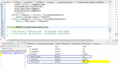

Hello @BerlinRaj
There are many errors in your code. So refer to your requirements, I create a project for you.  I have tested on my side, there is no issue when writing two pages and reading.
From the result, we can see write to flash 78 and 190. They are read back correclty.
I attach my project  for you.
Hope it helps.
Alice

BerlinRaj
hii @Alice_Yang , i just try to write the code this console
consider, i have to stored the VERSION and Temperature on the IAP FLASH Memory, and i displayed theVERSION and Temperature value with 1.8 inch TFT DISPLAY.

       //read part
	 uint32_t *read_ptr = (uint32_t *)(s_IapFlashAddress);
         uint32_t Version_value = *read_ptr;
	 uint32_t *read_ptr1 = (uint32_t *)(s_IapFlashAddress1);
         uint32_t Temp_value = *read_ptr;
	 print_tft(145, 2,Version_value , YELLOW_COLOR, BLUE_COLOR);
	 print_tft(145, 20,Temp_value , YELLOW_COLOR, BLUE_COLOR);

Whenever I write the above program, the FLASH MEMORY writes and reads the data properly.
However, whenever I hide the #Erace(DEMO_IAP_FLASH_SECTOR); function, the first data is not read properly, but the second data is read well. Why?
explain  these below two function if i hide why first data should not printed.
IAP_PrepareSectorForWriteone(DEMO_IAP_FLASH_SECTOR, DEMO_IAP_FLASH_SECTOR);
IAP_EraseSectorone(DEMO_IAP_FLASH_SECTOR, DEMO_IAP_FLASH_SECTOR, SystemCoreClock);
