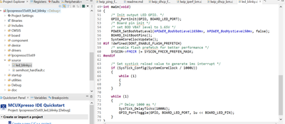

Harry_Zhang
Hi @joshmarripudi
You can refer the led_blinky demo.
LPCOpen Software for LPC17XX | NXP Semiconductors
Hope this will help you.
Hang
