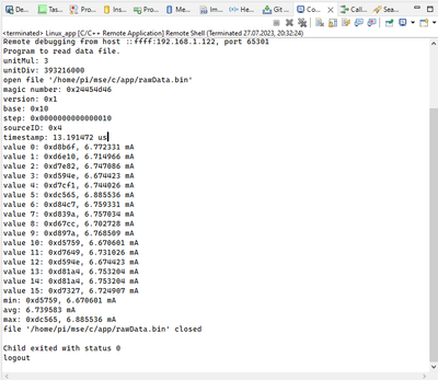

I'm trying to do some power consumption measures on my LPC55S69 with the MCU Link Pro debugger. I want to export those measures on my computer and display them on octave (same as matlab) but the problem is that the .bin generated with all the data is in a specific format that I can't understand.
Basically, I understood that there is a header of 22 bytes with for example, the magic number which is 4 bytes long. The problem is that I don't know the type of variable that is coded is it a float, fixed, int, uint? And this is the problem with all the variable in this file. The doc that I have is linked to this post.
If someone could help me with this it would be nice,

I'm working right now on a converter program (work in progress):
In short: You will need to do some byte swapping. The data items need to be multiplied/divided as in the documentation explained. The 64bit timestamp and average values are IEEE64 encoded, and here again you need to do byte swapping and then multiply/divide.
I have not sorted out the 'log' for the min-avg-max sequence.

I have started implementing it based on the information in the reference manual (you mentioned above) and looking at the data in the file.

Hi @Skyrise ,
just in case, I have published my work-in-progress on GitHub here:
https://github.com/ErichStyger/mcuoneclipse/tree/master/MCU-Link/EnergyMeasurement
Erich

Hi @Skyrise ,
Check getNofSummaryItems() in the code I have put on GitHub. This works for me.
I'm in the process of writing a blog article with details about it.

Hi @Skyrise ,
please check out the latest sources on GitHub. I worked on the timestamp thing today, and have applied a fix with some other timestamp improvements. Data looks correct on my side now.
