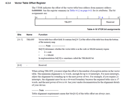

xiangjun_rong
Have you changed the Vector Table Offset Register? After you change the code address, you have to change the Vector Table Offset Register so that the code can find the correct interrupt vector table.
Hope it can help you
