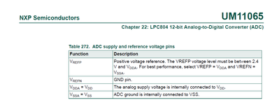

in the Datasheet mention that tie the Vrefp to VDD and Vrefn to VSS when ADC is not used.
in case ADC Used VREFP is connected to the ADC reference voltage but VREFN pin is not terminated out side how to connect the Analog Ground to VREFN
What is the consequences if ADC VREFN is connected to the Digital GND internally. what is the Effect on the ADC Readings.

5,941 Views
xiangjun_rong
For the LPC804 silicon, there is not  VDDA,VSSA pins, the VDDA is connected to VDD internally, the Vrefn, VSSA are connected to VSS internally.
Because LPC804 is a low cost and reduced package processor, the Vrefn and VDDA,VSSA pins are NOT connected to external pads as the following Fig.
Regarding the effect of above connection, I think maybe the digital noise take effect on the ADC sample result, but the noise is small.
Hope it can help you
XiangJun Rong
