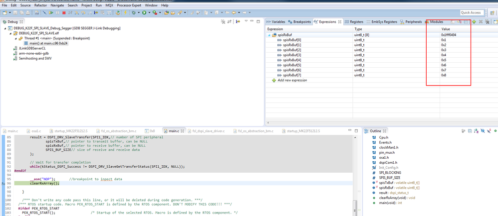

I am having issues with received slave spi data on the k22f using KSDK 1.3 and processor expert.  I have simplified the project using 2 frdm-k22f boards one as master and one as slave.  The master send 8 bytes of data 1-8 and I check on the slave to see that it received it.
The recieve data is not correct and sometime is will miss a byte being sent.  It misses 0d05 consistently.  When 5 is missed the rx does not know that the frame has finished and recieves the first part of the next frame.  It seems to be a timing issue, but I checked the phase,polarties and even slowed the master clock to a snails pace of 130Khz.
I have looked at the data on the scope and the tx data is fine.  See attachment to see the 0d05 value being sent (but no received on the slave).
I looked at the slave registers and the only thing that looks funny is that the SR.TFUF.  Though the sdk api sends a successful return.
I have simplified the project to 8 bytes from 16 where the more bytes are missed and things get worse.
Any ideas what is wrong?

I was able to get the sdk 1.3 non-blocking example code working.
The example code had to be modified to get it work with SPI1.  in hardware_init() function where the where it is hard coded for spi0 "configure_spi_pins(0);)" and should be a variable based upon the selected instance in main.  Second in order to get SPI1 to work I had to enable the clock for portd "CLOCK_SYS_EnablePortClock(PORTD_IDX);".
So it appears that there is a problem with the processor expert generated code.

Hi Alice,
Thank you for the reply.  I have had gnd connected from board to board in all tests.
I have been able to reproduce the same problem with the sdk example projects master/slave non-blocking at a high enough frequency of baud rate.  In order to use the drivers on my custom board I was not BOARD_ClockInit();, but was running of the default internal osc.  This was slow enough to cause the sdk drivers to fail at a baud rate of 1Mhz with the SDK drivers.  It appears I will have to use the pll to increase the internal clock to get the performance I need.

Hello  Michael,
Today , i test your project on my side again , it can work well use the default clock rate .
And i also configure it to 1M , it can work well also .
Hope it helps
