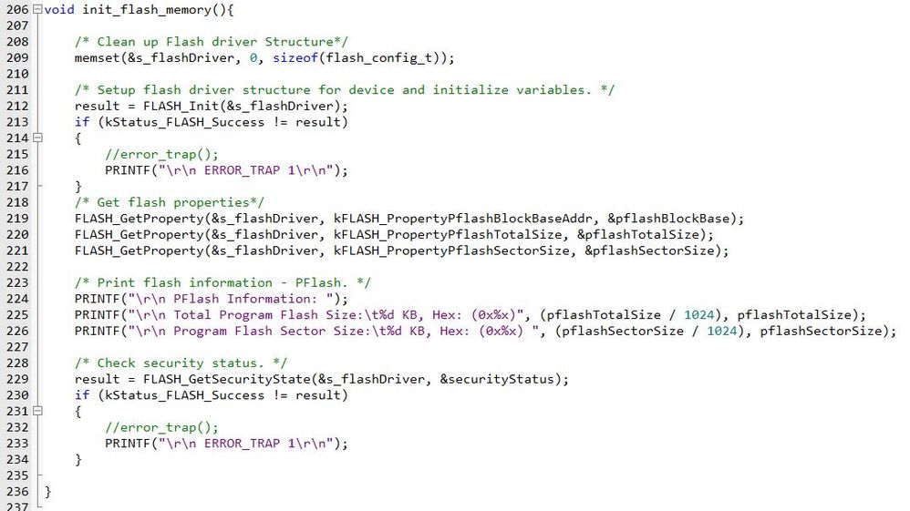

gauravbanyal
Hello Kerry Zhou,
Sorry about this mistake. The procedure init_flash_memory() is indeed something I have created. This encapsulates much of what is in the initialization in the example SDK_2.0_FRDM-KL03Z\boards\frdmkl03z\driver_examples\flash\pflash.
Below is my function. Could you please suggest what is the not-important code that can be removed?
Good day to you too!
Gaurav.

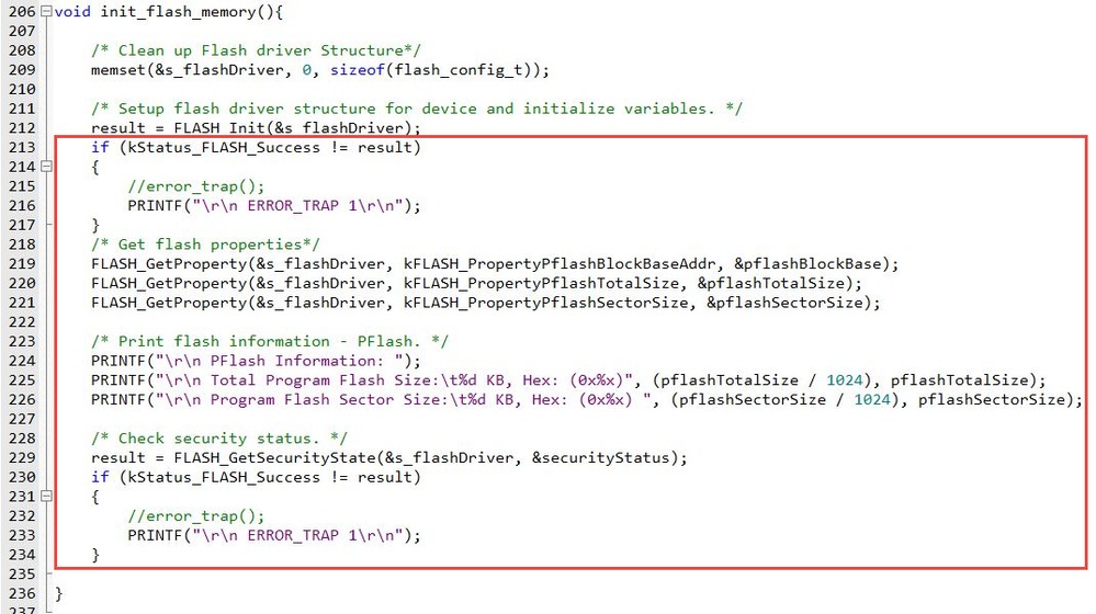

kerryzhou
Hi Gaurav Banyal,
    Please comment all the code in the red rectangle:
Then try again, in your code, PRINTF will caused a lot of time.
Wish it helps you!
Kerry
