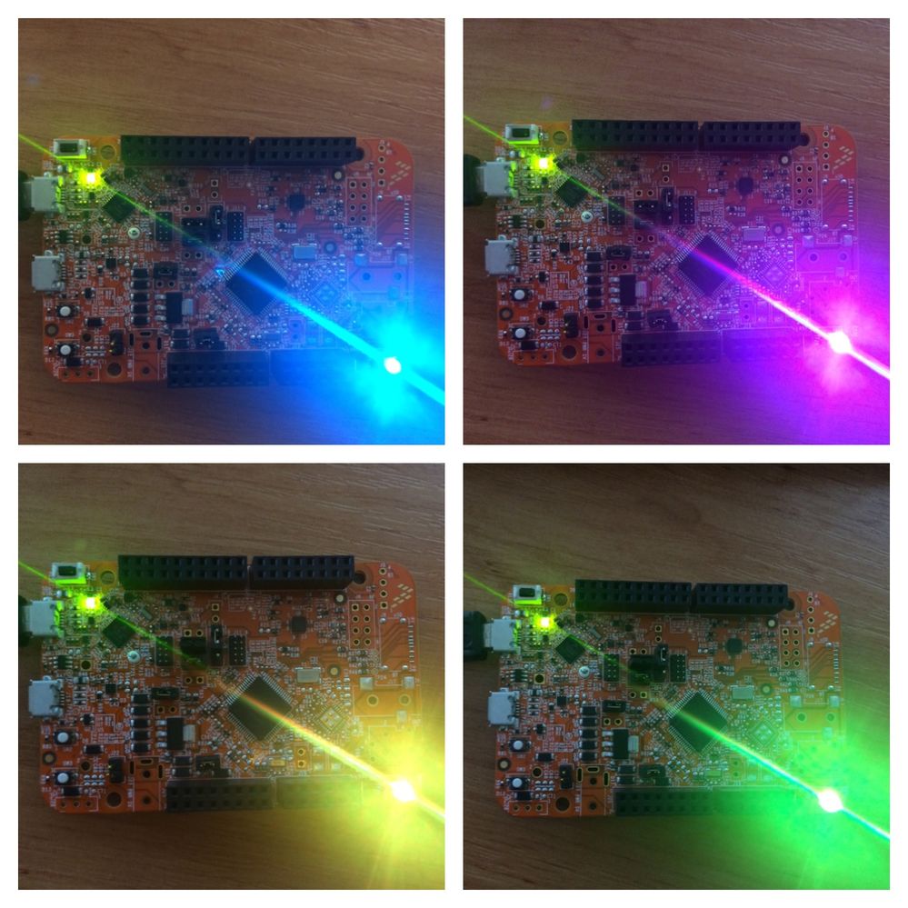

Hi all,
there is a simple modification of ftm driver example based on KSDK 1.3, KDS 3.0 on FRDM-K22F.

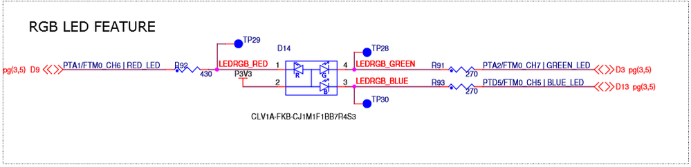

  • enabling clocks for PORTs in hardware_init.c
void hardware_init(void) {    /* enable clock for PORTs */   CLOCK_SYS_EnablePortClock(PORTA_IDX);   CLOCK_SYS_EnablePortClock(PORTD_IDX);   CLOCK_SYS_EnablePortClock(PORTE_IDX);    PORT_HAL_SetMuxMode(PORTA,1u,kPortMuxAlt3);//red   PORT_HAL_SetMuxMode(PORTA,2u,kPortMuxAlt3);//green   PORT_HAL_SetMuxMode(PORTD,5u,kPortMuxAlt4);//blue    /* Init board clock */   BOARD_ClockInit();   dbg_uart_init(); }

  • forwarding parameters to hsv2rgb()
hsv2rgb(hue,255,255,&red,&green,&blue,255);
  • changing hue and checking overflow of hue
        hue++;         if(hue>=360)hue=0;
  • normalizing from 0-255 to 0-100 percent of PWM pulse width for each color
        ftmParamR.uDutyCyclePercent = (uint8_t)(((float)red/255.0)*100.0);         ftmParamG.uDutyCyclePercent = (uint8_t)(((float)green/255.0)*100.0);         ftmParamB.uDutyCyclePercent = (uint8_t)(((float)blue/255.0)*100.0);
That´s all!

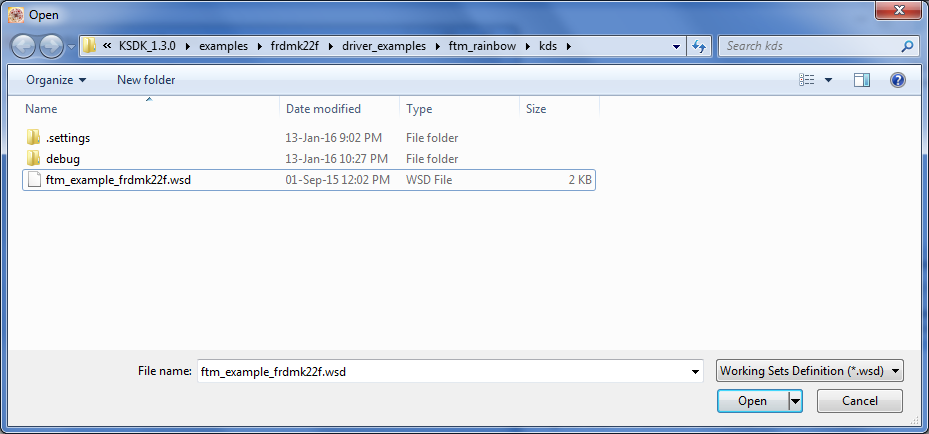

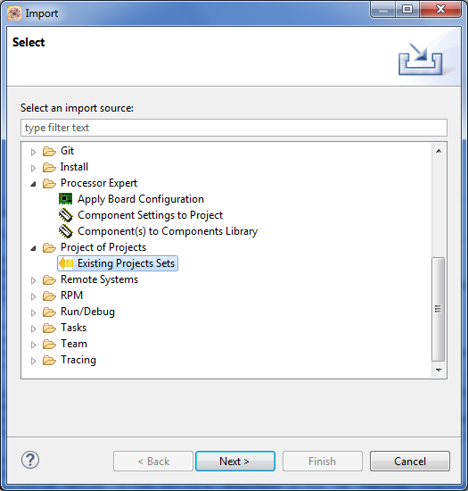

Importing example
  1. extract ftm_rainbow.zip to C:\Freescale\KSDK_1.3.0\examples\frdmk22f\driver_examples
  2. Go to KDS, import file
and choose .wsd file

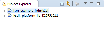

After then don´t forget compile library first and then project.
