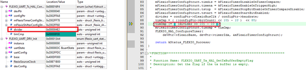

I found that it will configure register FLEXIOx_TIMCMPn(FLEXIO_UART_DRV_Init->FLEXIO_UART_Tx_HAL_Configure).
When flexio uart's baud is 9600, CMP[7:0] is not enough to store the value.
How could I resolve this problem?
