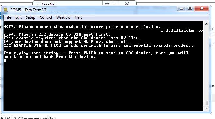

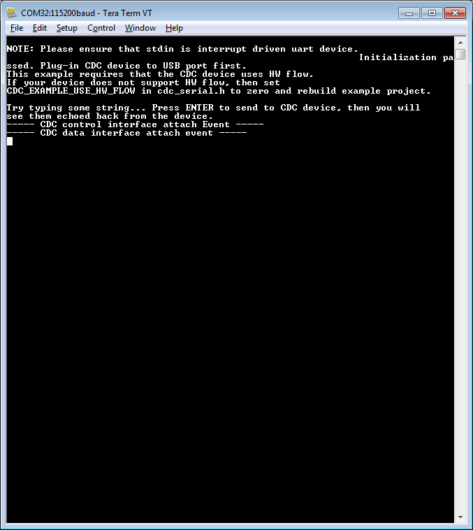

kooroshhajiani
It will pass the initialization phase but it does not attach the device:Capture_terminal.PNG
My project needs a K64 communicating to k20 . So why do I need to test MSD?
Koorosh

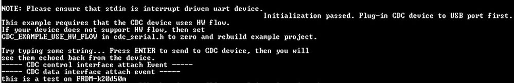

isaacavila
Hello Koorosh,
I testes the host_cdc example in TWR-K64F120M with J26 and J23 on (and software is using PTC8 and PTC9 to enable VBUS, this is default configuration for example) and on device's side, I am using a FRDM-K20D50M board and it is detecting and sending commands correctly (although, sometimes it get crash after sending some data to device).
I am using device example that is located at USB stack 4.1.1: <Freescale USB Stack v4.1.1_PATH>\Source\Device\app\cdc\cw10\kinetis_k20. Please notice that i am doing a workaround in device side in order to send data to host although it is being detected as it is by default.
Please check default jumper configuration on TWR-K64F120M.
I hope this can help!
Isaac

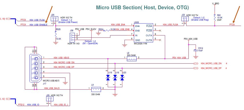

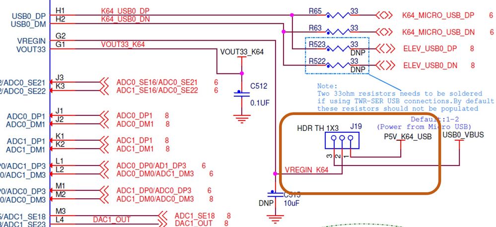

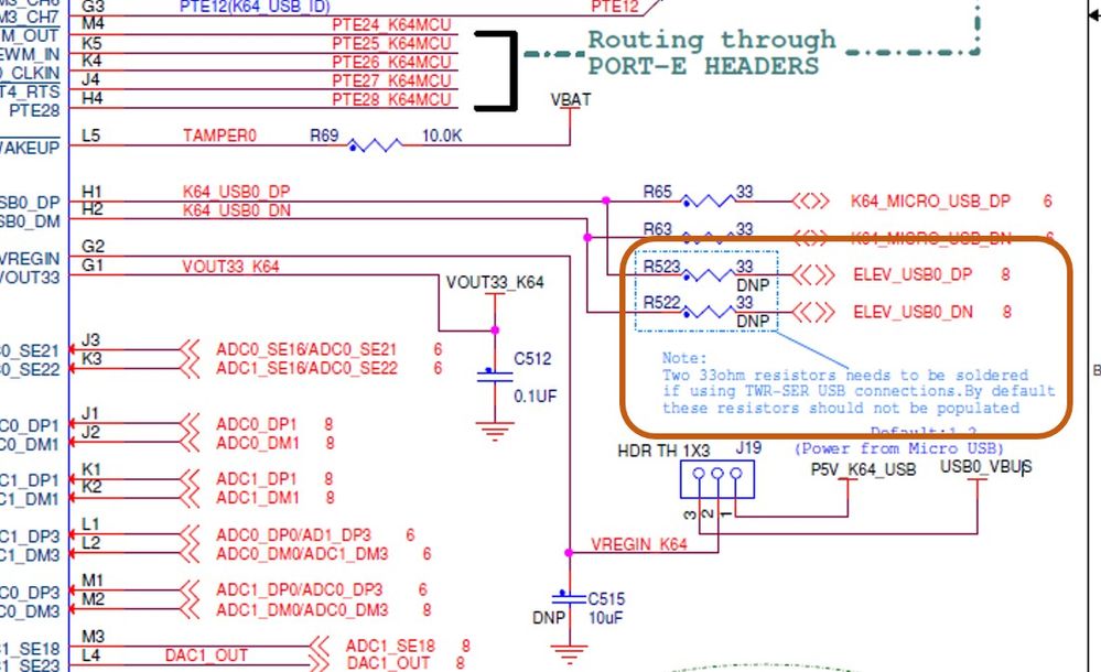

isaacavila
Hello Koorosh
What example are you using? (KSDK, MQX, etc)
By default, TWR-K64F120M board uses the on board J17 USB connector for its USB functionality, if you want to use TWR-SER or TWR-SER2 board you need to populate the R522 and R523 resistors just as shown below:
These two resistors are located at TWR-K64F120M's bottom side.

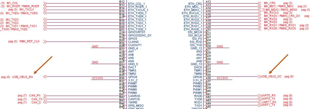

Also, in standalone implementation, PTC9 and PCT8 pins (along with J23 and J26 jumpers) are used to enable USB VBUS when working on USB Host mode
but in TWR-SER2 (or TWR-SER board), GPIO6 and GPIO4 (A35 and B35 connections in Elevator) are needed, so software should use PTB9 and PTB8 instead of PTC9 and PTC8 when using TWR-K64F120M and TWR-SER(2) boards.
If these considerations are already met, I would recommend to test a Host MSD example instead of CDC Host, this way you can see if detection problems are caused due CDC device is not supported by Host CDC example or it is a hardware issue.
I hope this can help you!
Isaac
