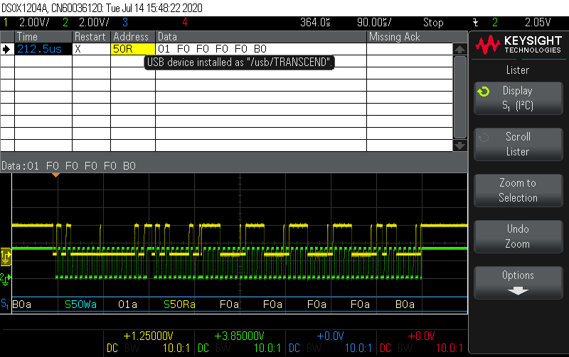

I am working on the I2C master mode and I2C slave mode using edma and interrupt method on K64F MCU.
I connect two k64F devices to test the I2C mode for master and slave.
The master I2C us used the edma to read 5 bytes data on slave address 0x50, subaddress 0x01.
The slave responds the 5 bytes data are 0xF0, 0xF0, 0xF0, 0xF0, and 0xF0.

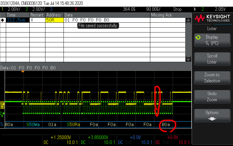

In fact, the real dates are 0xF0, 0xF0, 0xF0, 0xF0 and 0xB0

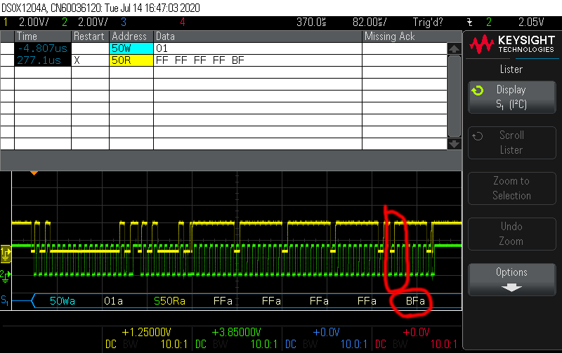

Even the dates are 0xFF, 0xFF, 0xFF, 0xFF, and 0xFF and the master receive 0xFF, 0xFF, 0xFF, 0xFF and 0xBF.
It seems the Bit 6 is set as Low Bit on the last bytes and the wave form is shown as below,
I have no idea what is going on ?
The master code is below,

Is the wave picture from  master?   If so ,the master is normal. Error happened on slave.
Have you get a wave picture of slave?
After confirm the error from,we can debug it, make a print on where error happens.

Can I ask why are you asking for a scope picture from the slave - shouldn't it be identical to the waveform that andyhsu‌ put in his post?
andyhsu‌, can I make a suggestion in your debugging?  Rather than load the TX register with a set value, could you set up an array with differing values or generate the values algoithmically (simply incrementing a variable would do) and pass that to I2C_SLAVE_BASEADDR->D?  I'm wondering if the interrupt handler isn't loading the TX register in time for the read and you're getting a previous/invalid value or something is getting copied into the register when you do the dummy read to release the bus.  By replying with differing values, you should see if this is happening.
Sorry, I don't have any experience with coding an I2C slave device (I swing more towards the master side of things) but based on my experience in debugging sent blocks of the same data, I would be suspicious that you're sending the data that you think you are in the first place.  That should be verified first to see if you have a problem with the last byte sent or there's a problem right from the start.
