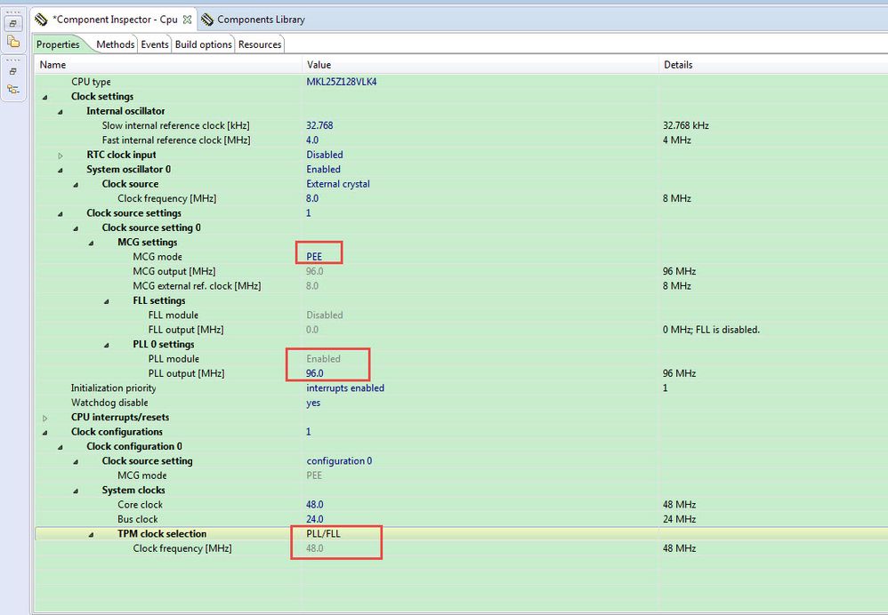

is it possible to use TPM from 48MHz clock and system and bus clock 24 MHz?  Device KL25Z128VLK.

    You can find the TPM clock source from the reference manual:
So, You can choose PEE mode, then use MCGPLLCLK, then your TPM clock will be 48Mhz.
Just like this :
Wish it helps you!
If you still have question, please let me know!
