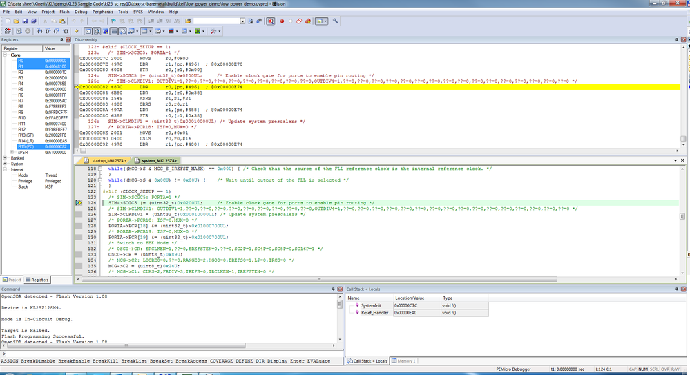

my question how to program a simple gpio pin to on or off by using "Just" assembly language programing and not using c++ in KEIL MDK.?

Kan_Li
Hi Deepak Siyal,
I think you may firstly debug the C code and know the assembly implementation via the Disassembly window just below:
Please kindly refer to the following for more details on the assembly language: http://infocenter.arm.com/help/topic/com.arm.doc.dui0662b/DUI0662B_cortex_m0p_r0p1_dgug.pdf
