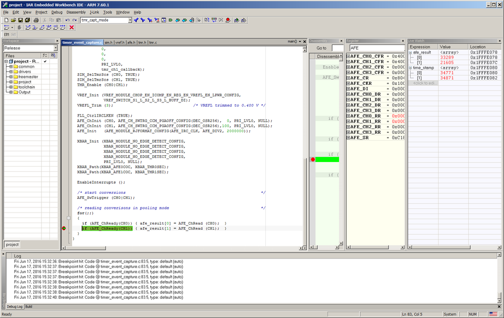

Could you please advise if that is possible to set XBAR to handle several events?
For example, if we use KM34, is it possible to set XBAR to handle these two events:
1. to capture timer1 data as we get positive comparator output
2. to capture timer2 data as we get sample available from AFE2
If such scenario is possible, could you please recommend a software examples for reference?

you can make simultaneous interconnections through XBAR module; your use-case aka events time stamping can be implemented. For more details, please refer to bare metal drivers (refman.chm, XBAR section) https://www.nxp.com/webapp/Download?colCode=KMSWDRVAPIRM_SW&location=null&Parent_nodeId=134851851102....
Here is print screen of the timer_event_capture example that implements time stamping of two phase shifted AFE conversions using Timer capture and XBAR:
The MKM34 platform doesn't support AOI module so performing logic functions on XBAR inputs is not possible as Rong explained but event time stamping as well as simultaneous signal interconnections can be realized.

I do not think that the KM34 can implement that function that you OR two events. For the DSC for example MC56F84xxx or KV5x families, there is AOI module(AND/OR/INVERT (AOI) Module), which enable you OR two events, but the KM3x does not have the AOI module, so it can not implement to OR two events.
Hope it can help you
