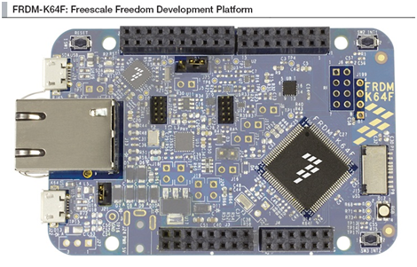

  1. FRDM-K64F board
Fig1 FRDM-K64F

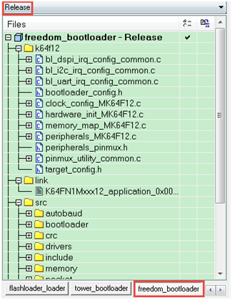

        I. Open the the bootloader project, for instance, using the IAR and select the freedom_bootloader demo
        The Fig 2 illustrates the bootloader project for K64 which resides in ~\NXP_Kinetis_Bootloader_2_0_0\NXP_Kinetis_Bootloade
r_2_0_0\targets\MK64F12.
Fig 2
     II. After compiles the demo, then clicks the  pastedImage_19.pngbutton to program the demo to the K64

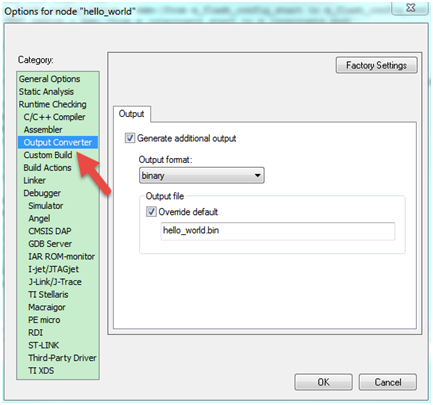

        After open the hello_world demo in the IAR, using project options dialog select the "Output Converter" and change the output format to "binary" for outputting .BIN format image (Fig 3). Next, build the application demo, then the .BIN file will be generated after the building completes.
Fig 3

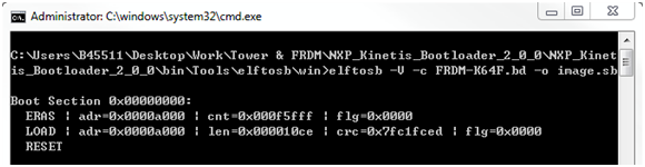

     IV.  SB file generation
         After creating the BD file shown in the following figure, copy the "hello_world.bin", elftosb.exe, and the BD file into the same directory. Then, open the window with command prompt and invoke
elftosb such as “elftosb –V –c FRDM-K64F.bd –o image.sb”. The elftosb processes the FRDM-K64F.bd file and generates an
image.sb file. Elftosb also outputs the commands list as shown in Fig 4.
pastedImage_58.pngFig 4
