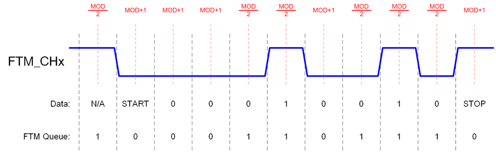

Before creating an application to emulate a UART, the UART protocol and encoding must be understood. The UART protocol is an asynchronous protocol that typically includes a start bit, payload (of 7-10 data bits), and a stop bit but does allow for many variations on the number of stop bits and what/how to transfer the data.  For this document and application example, the focus will be UART transmission that follows 1 start bit, 8 data bits, 1 stop bit, no parity, and no flow control.  The data will be transmitted least significant bit (LSB) first.  The following image is a block diagram of this transmission.

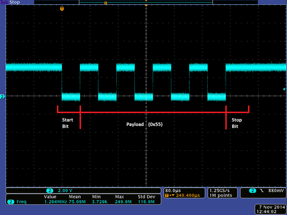

However, this doesn't specify what the transmission looks like electrically. The figure below shows a screenshot of an oscilloscope capture of a UART transmission.  The data transmitted is 0x55 or a "U" in the ASCII representation.
Notice that the transmission line is initially a logic high, and then transitions low to signal the start of the transmission.  The transmission line must stay low for one bit width for the receiver to detect it.  Then there are 8 data bits, followed by 1 stop bit.  In the case shown above, the data bits are 0x55 or 0b0101_0101.  Remember that the transmissions are sent LSB first, so the screenshot shows 1-0-1-0-1-0-1-0.  The last transition high marks the beginning of the stop bit and the line remains in that state until the start of the next transmission.  The receiver, being asynchronous, does not require any type of identifying transition to mark the end of the stop bit.

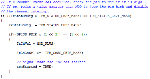

For the first issue, the channel interrupt is first enabled and the channel value register is loaded with a value much less than the value in the MOD register.  Then in the channel interrupt service routine, the pin is sampled to ensure that it is in the logic high state and the channel interrupt is disabled (and will not be re-enabled throughout the life of the application).  The code for this interrupt service routine is as follows.
Output pin control
For the second issue, a method of not transitioning the pin value while allowing the timer to continue counting normally is necessary.  The Output Compare mode uses the channel value register to determine when the pin transition occurs.  If a value greater than MOD is written to the channel value register, the channel value will never match the count register and thus, a pin transition will never occur.  So, when a series of continuous 1's or 0's need to be transmitted, a value greater than the value in the MOD register can be written to the channel value register to keep the output pin in its current state. However, when a value greater than MOD is written to the channel value register, no channel match will occur (which means channel interrupts will not occur).  So the timer overflow interrupt must be used to continue writing values.  This requires the updates to be output pin to be planned ahead of time and makes the transmission algorithm a little tricky.  The following diagram displays when which values should be written to the channel value register at which points in time to generate the appropriate pulses.

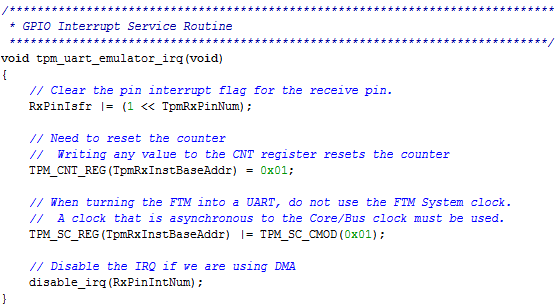

The receive pin needs to be able to determine when the start of the packet transmission begins.  To do this, the receive pin is configured as an FTM / TPM pin. At the same time, the GPIO interrupt functionality is configured on the same pin for a falling edge interrupt.  The GPIO interrupt capabilities are enabled in any digital mode, so the GPIO interrupt will still be able to be routed to the Nested Vector Interrupt Controller (NVIC).  The pin interrupt is used to start the FTM / TPM clock when a new character reception begins. In the GPIO interrupt for this pin, the FTM / TPM counter register is reset and the clock to the FTM / TPM is turned on.  The code for the GPIO interrupt service routine is shown below.

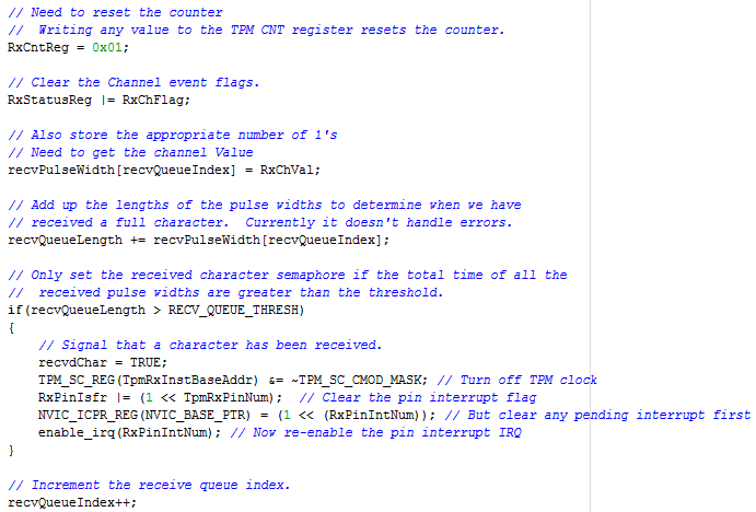

Now, when receiving characters and not using DMA, the first thing to understand is that the Interrupt Service Routine (ISR) will be used and it will mainly be used to record the captured count values.  The interrupt service routine also tracks the current receive character length and resets the counter register.  This is so that the values in the receive queue reflect the time since the last pin transition.  The interrupt function for the non-DMA application is shown below.
Notice that the first two actions in the ISR are resetting the count register, and clearing the channel event interrupt flag.  Then the channel value is stored in the receive pulse width array (this is simply an array that holds the receive pulse widths of the current character being received).  Next, recvQueueLength, the variable which holds the current length of the character being received, is updated to reflect the latest character length.  The next step is to determine if the full character has been received.  This is determined by comparing recvQueueLength to the RECV_QUEUE_THRESH, which is the threshold as determined by multiplying the number of expected bits by the expected bit width plus another bit width (for the start bit).  If the recvQueueLength is greater than the RECV_QUEUE_THRESH, then a semaphore is set, recvdChar, to indicate that a full character has been received.  The FTM / TPM clock is turned off, and the pin interrupt functionality of the receive pin is enabled.  The final step in the interrupt routine is to increment the receive queue index, recvQueueIndex.  This variable points to the current entry in the receive queue array.

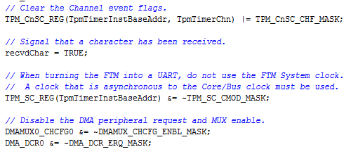

Using DMA to receive characters
When using DMA, the receive FTM / TPM interrupt is much different. The interrupt routine simply needs to clear the channel interrupt flag, stop the FTM / TPM timer, disable the DMA channel, and set the received character semaphore.  The character is then decoded outside of the interrupt routine.  The interrupt function when using DMA is shown below:
