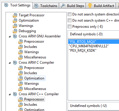

  8. Specify your CPU type in the C++ compiler settings, as shown below
  9. Generate code
In addition to main.c, after you generate code, you'll also end up with os_tasks.c.  Your PEx components will have C code added to the Generated Code folder.  At this point, it should be possible to wrap components in C++ classes.  Tonight, I ran a simple test where I wanted one of my MQX tasks to blink an LED.  The LED blink code was wrapped in a simple C++ class, and in order to be able to create the C++ object to call into, you have to call it from C++ code!
The solution ends up being pretty simple.  Rename main.c to main.cpp, and rename os_tasks.c to os_tasks.cpp.  Then generate code again.  Click on your Sources folder and hit F5.  You will see that main.c and os_tasks.cpp reappear, because they get re-created.  Right click on each of them and click Resource Configuration -> Exclude from Build.
Click Select All, then Close.  This will prevent those files from being compiled.  Note that if you add more OS_Task components, you will need to manually update os_tasks.cpp accordingly.
