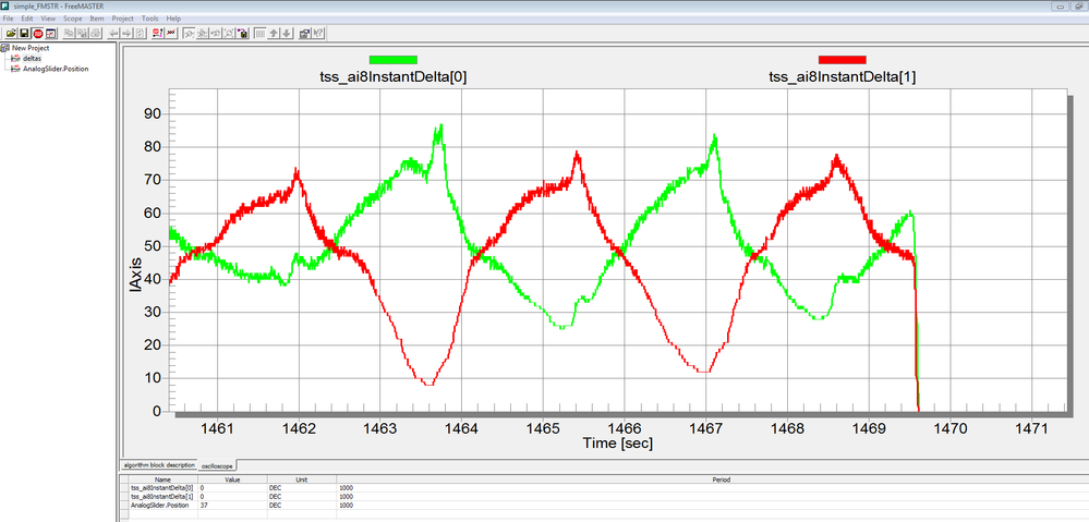

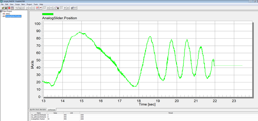

The visualization output has 2 separate scope windows:
  • one showing signals captured from electrodes of slider
  • another one showing position of finger on a slider

There are two independent snapshots below, showing the response to my finger movement along the slider

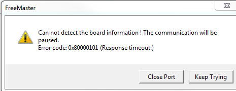

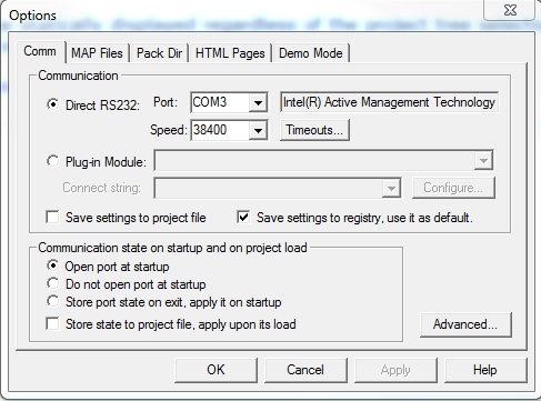

I tried this demo but I cannot get any communications. I'm using Freemaster v1.4 (just downloaded).

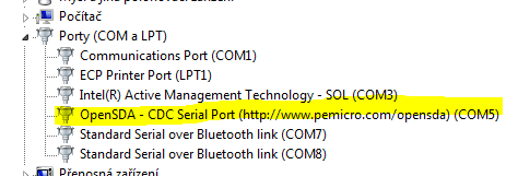

I only have COM3 showing up on my system: Intel Active Management Technology - SOL, is this correct?
this is how I configured it in Freemaster:
but I get this message:

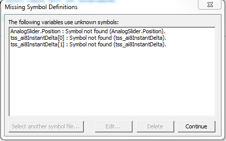

When I open the provided pmp file I get the following error:
btw, I tried connecting to both USB jacks on the Freedom board, however I am assuming the OpenSDA one is the correct one?

Hi Andrea,
I do nat have a clue about I AMT.

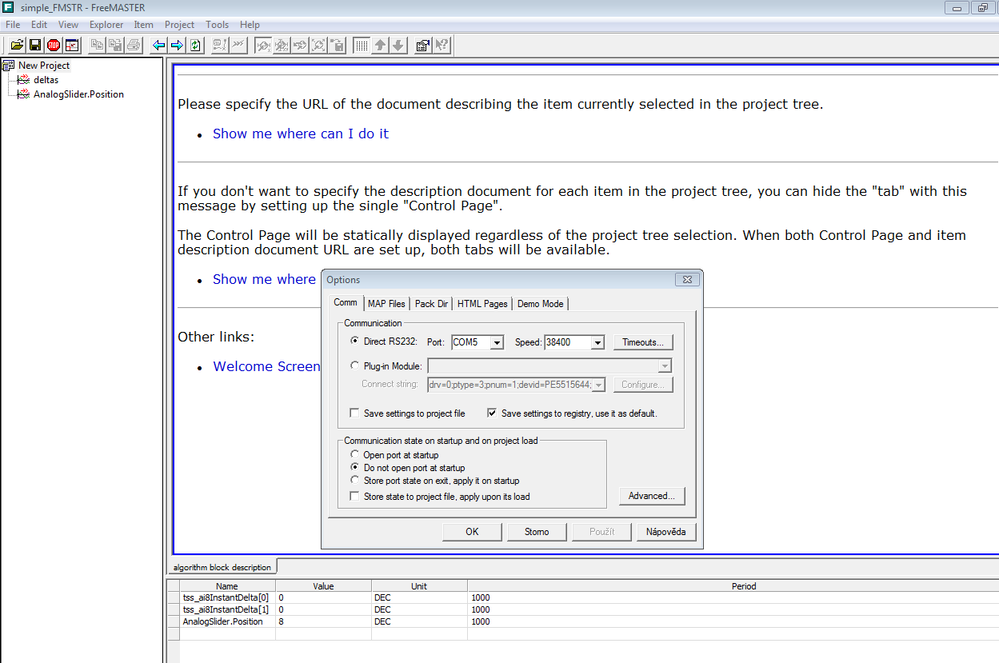

To check the functionality - I have downloaded the codes from the attachments,
first, I have loaded the application Freedom_KL25z.s19 into Freedom board (using MSD bootloader by drag and drop into FRDM_KL25Z drive on my PC)
you can see red led shining based on finger position on the slider of the board.
Next take a look into your hardware and check which is the correct COM port, in my case I have it this way
go to Freemaster, go to menu Project/ Options (Ctrl+T) and apply this connection
and by hitting the stop sign I was able to run the project successfully, I am using FreeMaster 1.3.15.0 Build jul 27 2012.
It works correctly on my side, so check out your com connection if it is not ok, drop me a msg, we can take a look of how to make it functional
Pavel
Hi Pavel,
thanks for the reply. I got it working by installing the PE OPenSDA firmware. I had the CMSIS firmware in there and it does not implement the pass-through serial port. The PE driver does, Windows sees it and I got the demo working.
