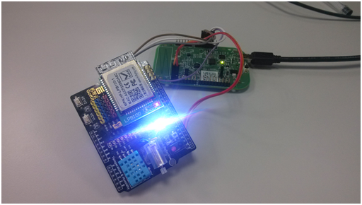

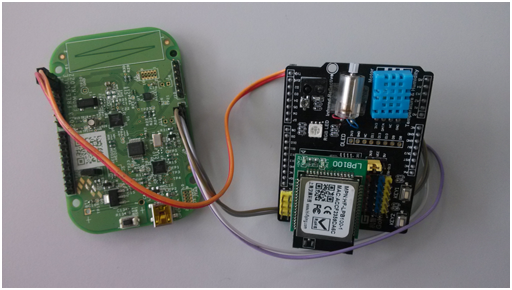

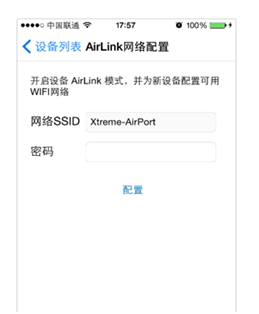

As general introduction on thread https://community.freescale.com/docs/DOC-328302 , I did a smart LED application with GoKit and FRDM-KL02.
In this design, FRDM-KL02 will communicate with GoKit by WIFI, and control LED flash.

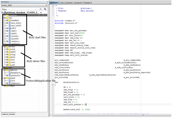

Code Structure
Code Basic Introduction
In this project structure, you need to do following items on code.
  • ü Add your functions, such as UART, LED, motor driver code.
  • ü Add function running functions in protocol.c
  • ü Add functions order in main loop.
You can find my main.c and protocol.c as attachment.

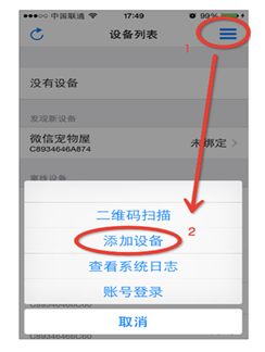

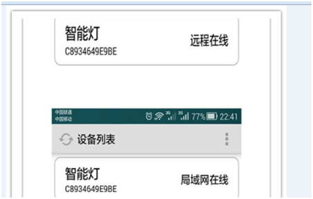

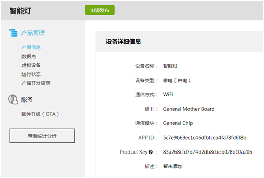

After that, you can do operations mentioned in thread https://community.freescale.com/docs/DOC-328302. You can see smart LED device and been found.
