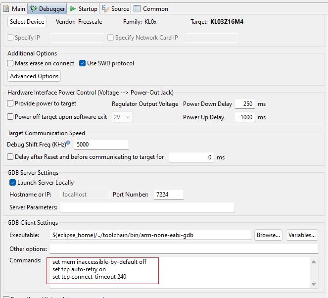

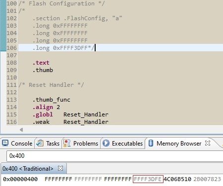

1) The memory looks fully exposed to the Memoy Browser
2)The data in FlashConfig sector looks different fom what expected , FTFA_SEC=0xFFFF3DFE despite in code it was set FTFA_SEC=0xFFFF3DFF.It looks that in code there are at least 2 ways to do that .
In startup_MKL03Z4.s or ,as you suggested ,in code ,by the declaration of FlashConfig.
In both ways something else overrides this configuration,as shown in screensot
Could it be something in debug confguration?
The only thing that i see related to flash security is in the box Commands
Thank you
