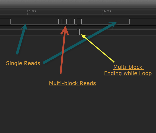

The picture below shows a File read request from FatFS.  Since the data from the card is NOT on sd card sector boundaries, FatFS needs to make a single SD read, followed by a Multi-Block, followed by a single SD read.
The traces shown have the actual read operation active LO.
You can see the first and last single SD read with a multi-block read in the middle.  The second trace shows the while loop stated above which ends the multi-block read.
Hope this helps someone else.  NXP/Freescale does NOT have any documentation in the K64 Reference Manual on how to properly recover from using the Auto-CMD12 feature of the SDHC controller.
