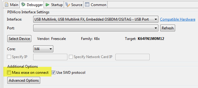

After reviewing the schematics the only thing I would recommend is to place a 0.1 µF capacitor to GND in the JTAG_RST pin. I don't think the tamper pins could have secured the device nor the I2C pins. Have you tried creating a new project and flashing it to the MCU? Is it possible that you send me the project that was first flashed to the board?
About how to recover the secured MCU, please try enabling the "Mass erase on connect" option on the debug configurations:
If the MCU does not get unsecured you could use the P&E Recovery Utility, please take a look to the following post:
Bricking and Recovering FRDM-KL25Z Boards: Reset, SWD Clock and Low Power | MCU on Eclipse
