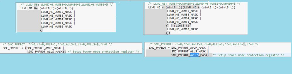

I am checking the code of both project and I found some difference that probably are causing what you reporting. Check the image below the code shown in the left side correspond to the 32pin and in the right to the 80pin.

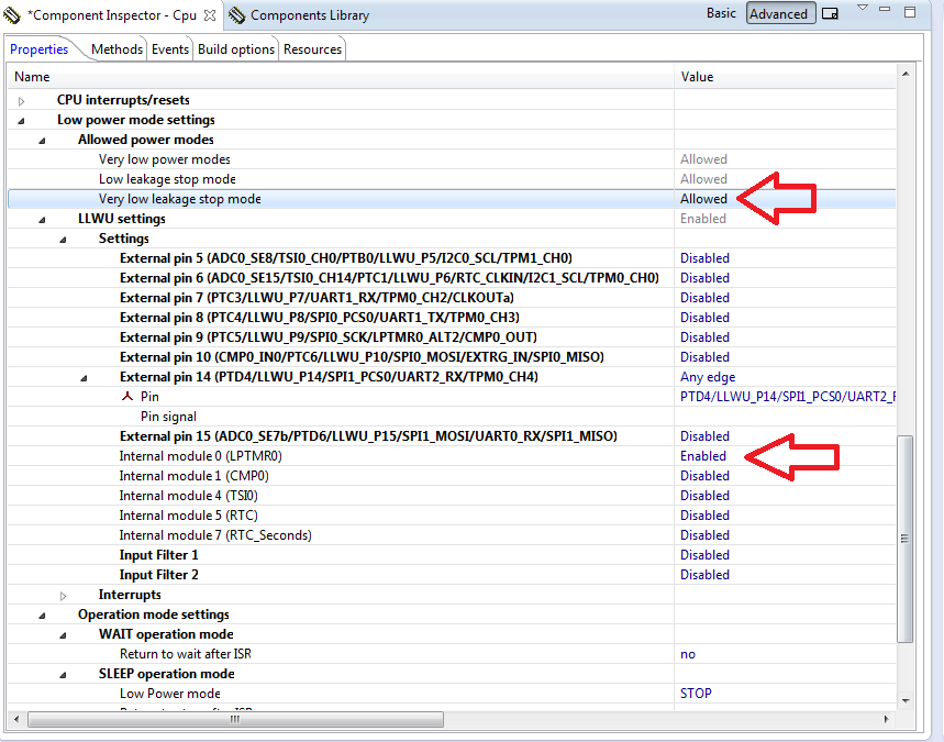

  • In the LLWU Module Enable register (LLWU_ME) the field WUME0:
          LLWU_ME &= ~LLWU_ME_WUME0_MASK this is WUME0 = 0
          if
          WUME0 = 0 --> Internal module flag not used as wakeup source
          WUME0 = 1 --> Internal module flag used as wakeup source
  • In the Power Mode Protection register (SMC_PMPROT) the field AVLLS
          by default the value is 0
          if
          AVLLS = 0 --> Any VLLSx mode is not allowed
          AVLLS = 1 -->Any VLLSx mode is allowed
The with the values in the 32pin code VLLSx modes are not allowed and another module's flag cannot be the wakeup source. You need to change this register in the component inspector of the CPU: click on the component CPU:MKL25Z32VFM4>click Advanced in the upper right corner> got to the values the image below shows> Enable Very Low Leakage stop mode > enable internal module 0 (LPTMR0) > Create processor expert code > Compile project
I hope this information can help you.

I haven't enable my LPTMR in CPU setting that is the reason my wake up timer was not working.
I tried wake up timer without going into LLS mode and it is working.
But when i enable timer and call "Cpu_SetOperationMode(DOM_STOP, NULL, NULL);"  for entring into LLS mode.
My wake up timer is not working.
Also i am not getting reason why my PWM is not working it is not related to low power mode.
