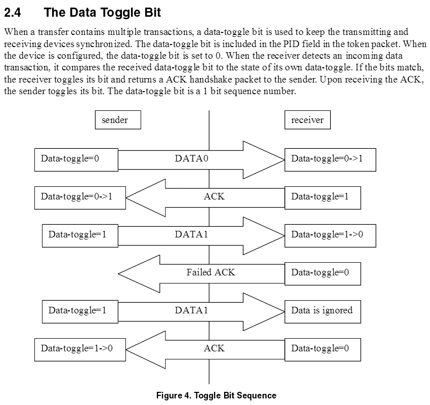

Here is DATA0/1 sequence from AN3492 (USB and Using the CMX USB Stack) ...

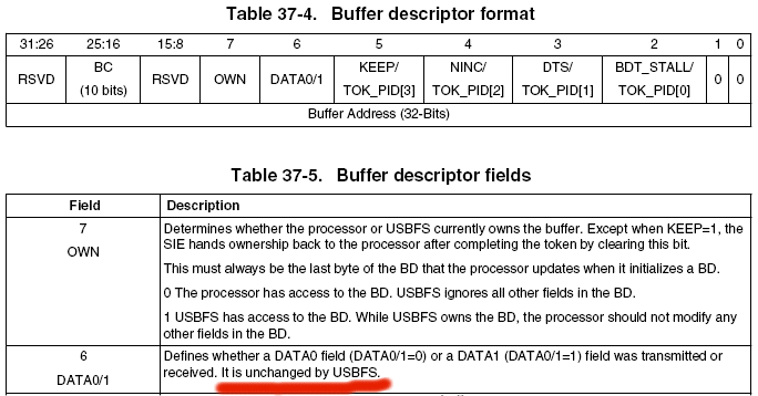

1) Let say that PC (host) send data over bidirectional EP1 (cdc, bulk) to KL27 (device). Device receive [OUT] token done, but where this DATA0 (data-toggle=0) value from host is stored on device side. Device "know" that it should be DATA0 (after completed enumeration), but where is host DATA value written  to compare it with expected value on KL27 side? In KL27 RM it is noted that DATA0/1 field can not be modified by USBFS, only by KL27 program.
I can't find in KL27 SDK USB source anywhere checking for DATA0/1 values (between host and device) and recovery process after failed transfer (lost synchronization).
2) Let say that KL27 (device) send data to PC (host) over bidirectional EP1 (cdc, bulk). This DATA0/1 is another one, as I can see from KL27 SDK USB source, bidirectional EP have two DATA0/1 values (Data1[RX] and Data1[TX]). After completed enumeration, device will send data packet to host with DATA0, and host will respond with [IN] token done. Where is stored DATA value from host that can be checked on KL27 side? Again, In KL27 RM it is noted that DATA0/1 field can not be modified by USBFS, only by KL27 program.

bobpaddock
Senior Contributor IV
"DATA0/1 field can not be modified by USBFS, only by KL27 program."
The Freescale/NXP manual leaves a lot to be desired.
This document from Microchip has far better explanation.
See 27.3.5.3.4 Buffer Descriptor Format:
http://ww1.microchip.com/downloads/en/DeviceDoc/61126F.pdf
The USB core is a purchased IP from a third party so it shows up in different parts from different manufactures.
Bit-6 will be modified by the host on inbound PID.
3,552 Views
bobpaddock
Some of the documentation intermingles the USB Spec. Data Toggling  of DATA0/1, with the parts double buffered Odd/Even pingponging.  They have nothing to do with each other.
Disable the Data Toggle Synchronization (DTS) bit in the setup register and see if anything changes.
If things improve with that turned off, it means that DATA0/1 is out of phase at some point, or not in the expected initial state.
Bad idea to leave it turned off other than as a diagnostic.  USB is not as error free as one would hope I have found.
