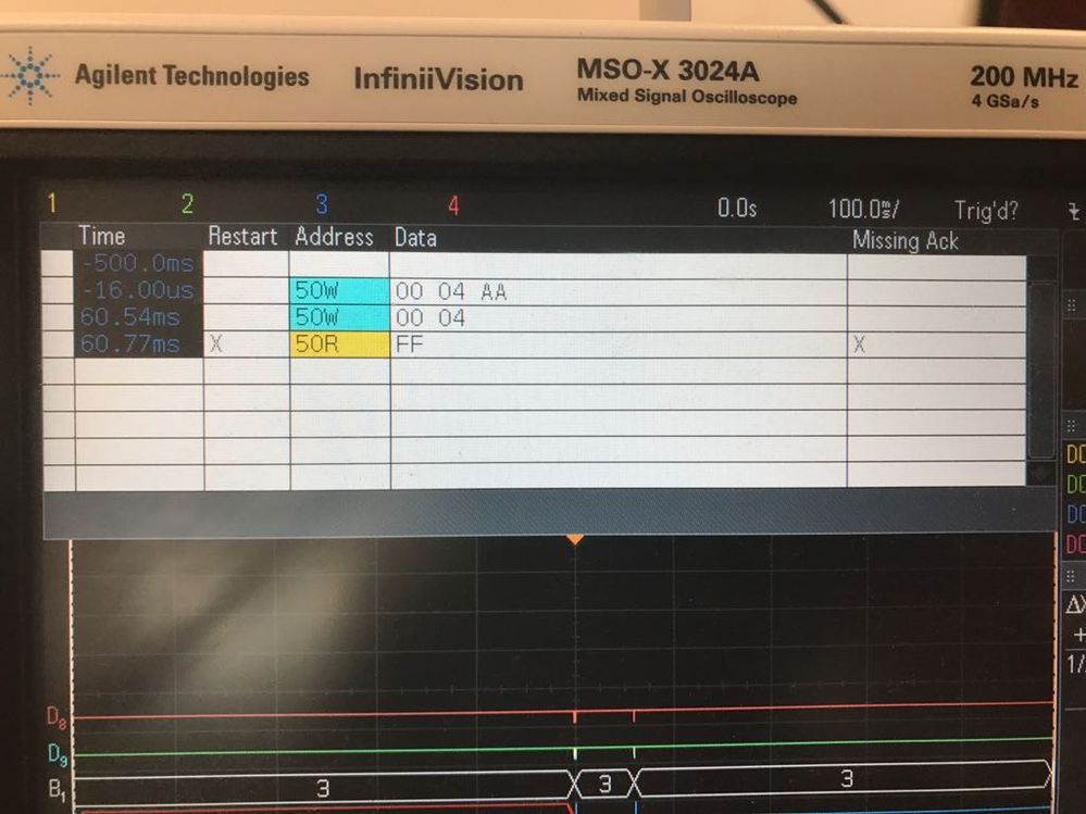

I have a question on using the I2Cmodule. I am writing the driver for an I2C EEPROM and I need to do the following for performing a read operation on the EEPROM. Note that after sending the address of the byte I want to read, I have to send a start again (without a preceeding stop). This doesn’t seem to be possible in I2C module.
How I am trying to achieve this is by doing two transactions on the I2C bus. First to write the “Byte addr” bytes. This I am ending without a STOP bit. The next to read the data byte.

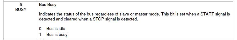

The “kStatus_I2C_Busy” is returned from the following code inside I2C_MasterStart() function and below is the explanation of this from the reference manual.
    /* Return an error if the bus is already in use. */
    if (statusFlags & kI2C_BusBusyFlag)
        result = kStatus_I2C_Busy;
Please suggest me how I can achieve the I2C communication needed to perform a read operation on this I2C EEPROM.

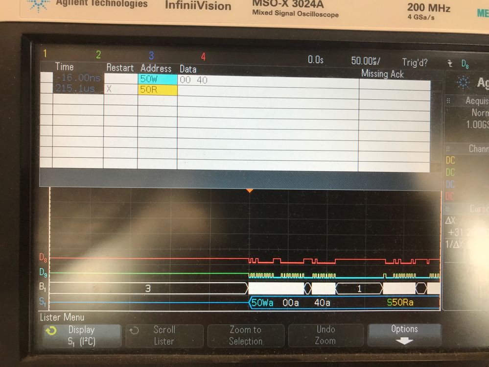

Now my understanding is that a repeated start means when a "start" is sent without a "stop" preceding it. I now think I was doing it wrong earlier. So I changed the red colored code below to "masterXfer.flags = kI2C_TransferRepeatedStartFlag". With this, I see that the read is sent on the bus. Now the problem is that no data is returned.
masterXfer.slaveAddress   = EEPROM_I2C_SLAVE_ADDR_7BIT;
masterXfer.direction      = kI2C_Read;
masterXfer.subaddress     = (uint32_t) address;
masterXfer.subaddressSize = 0;
masterXfer.data           = data;
masterXfer.dataSize       = 1;
masterXfer.flags          = kI2C_TransferDefaultFlag;
status = I2C_MasterTransferBlocking( i2c_handle, &masterXfer ); // This always returns error kStatus_I2C_Busy
With this change following is what I see on the scope:
Could you please elaborate on the workaround or could you point me to the right discussion on the forum which talks about this case?
Gaurav.

General format for EEPROM read is:
Start
Device_Address Write
Write_EEPROM_ADDRESS_High (or low depending on the part)
Write_EEPROM_ADDRESS_Low
Repeated Start
Device_Address Read
Read/Ack
Read/Nack Nack indicates this is the last read.
The master still needs to generate the clocks so there needs to be more than one read.

I figure out from the Appendix you shared that the typical issue is that the i2c master, after sending the repeated start sends a wrong slave address. But this doesn't seem to be happening in my case. Here it seems to be that I am able to read but the slave is not returning the right information.
In this, I write 0xAA at address 0x0004 and then try to read address 0x0004. What do you think could be wrong here? Do you think its the double buffering bug? how?
Cheers,
Gaurav.
8,766 Views
mjbcswitzerland
Specialist V
I am not sure whether this is a chip issue, driver issue or application issue yet but it looks like your write doesn't correspond to what you display in the initial post. There you show that you want
W50, 0, 4, W50, AA
but your oscilloscope is displaying W50, 0, 4, AA, which is different because the slave is never being addressed for the data write (the second W50 is missing).
In this case it may be normal that the read is a 0xff since you haven't written anything yet.
If you intended to send the second W50 between the 4 and the AA if could be the chip bug where the second start address is lost (as noted in the appendix of the uTasker I2C document).

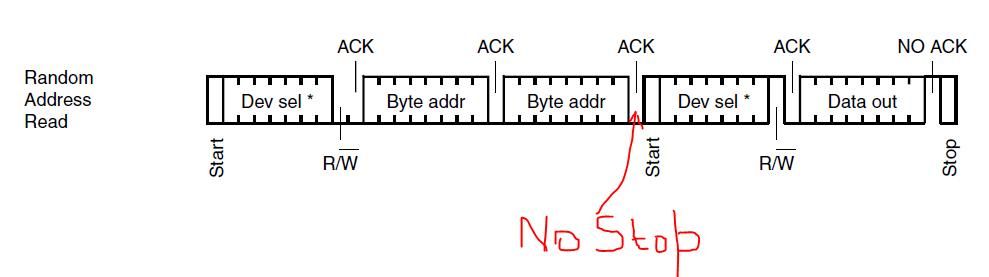

Section 5.2.1 of the data sheet does indicate that Repeated Start is used, it just doesn't call it that in that paragraph.
8,766 Views
mjbcswitzerland
Specialist V

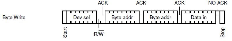

Section 5.1 "Write operations":
When the bus master generates a Stop condition immediately after a data byte Ack bit (in
the “10th bit” time slot), either at the end of a Byte Write or a Page Write, the internal Write
cycle tW is triggered. A Stop condition at any other time slot does not trigger the internal
Write cycle.
A repeated start will presumably effectively cancel a write before it starts.
Also, the user's manual discusses how to poll for the write to complete in 5.1.6.
I also agree that, from 5.2.1, a repeated start is required (must be used) when reading.
From 5.1.1. the write address plus the data should be written in one single I2C frame. It doesn't state that it won't work if a repeated start is used but it is not the method that is explained and possibly will fail. Sending as two write frames looks to be incorrect since the second one's data will presumably be understood as a part of a new address and not as data.
Therefore it looks like the present problem is at the application level where there are one or more errors as it is being performed at the moment.
