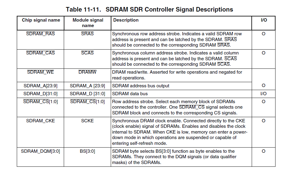

Hi I`m thinking of using the MK66FN2M0VLQ18 in a project and need to add SDRAM but I`m a bit confused as I cannot find any examples. It seems that Databus 0 - 15 is not available on FB_AD0-15 as it is used for the address lines - Do I need to use latches to multiplex the data bus with the address lines?

Regarding your question, i am a bit confused, do you interface with SDRAM or SRAM? if you hook SDRAM, you have to use SDRAM SDR controller to connect, if you use SRAM/Nor flash, you can use FlexBus to connect.
If you use SDRAM, pls refer to the follwoing table in reference manual of K66.
Pls tell us the device even part number you want to hook.

When using 16-bit wide SDRAM and D16-D31 on the MCU (mandatory from what I understand), is this realy correct:
125PTC18SDRAM_DQM1 39SDRAM_DQM1
126PTC19SDRAM_DQM0 15SDRAM_DQM0
I thought one should connect MCU DQM3 and DQM2 to SDRAM DQM1 and DQM0, or?

stonos
Hi Daniel,
I am working with K65, but the Reference manual looks the same. We are about to order a board any day. What I have been looking at is "Figure 35-2. Connections for External Memory Port Sizes" and from that figure my conclusion is that BS3 and BS2 shall be used with 16-bit wide memory (BS[3:0] is the DQM, see table 35-2). You can also check this thread on the same topic: https://community.nxp.com/thread/437787

When checking table 35-2 BS[3:0] should be interpret as "Byte Select" and not "Bank Selection":
"SDRAM byte selects BS[3:0] function as byte enables to the SDRAMs. They connect to the DQM signals (or data qualifier masks) of the SDRAMs.".
In Figure 35-2 the BS signals have the text "Byte Enable" to the left of them to make it more confusing.
A problem is that NXP uses BS instead of DQM in the Reference manual and DQM in the Datasheet not BS.
I am still not 100% sure what is right, but I whould really like be 100% sure before we order our board...

danielrumary
Hi I have contact NXP and they kindly reviewed the design for me, it looks like the design was wrong and that the DQM signals need to connect to DQM2 and DQM3.
Also just to clarify the Bank address lines are correct:
In terms of the Bank Address lines, on the SDR these select one of the 4 internal banks. To make the memory space mapped to the K66 contiguous, we use the next 2 address lines. So I’m happy with using SDRAM_A22 and SDRAM_A23 connected to BANK_SEL0 and BANK_SEL1. That is consistent with both the TWR schematic and the Table 35-16 example in the device reference manual (pdf page 900) of Rev2 reference manual.
So with reasonable confidence below is how you connect 128Mbit of SDRAM to the MK66 in 16bit mode, although we will only 100% know once we have re-spun the PCB.
