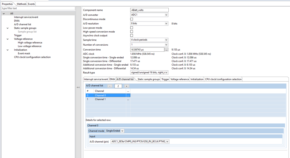

Hi, I'm using ADC1 (MK22FN256) to make a Single-ended and Differential Measurement.
What's not clear to me is how to write code that will retrieve measurementss from Channel-0 (ADC1_SE5b) and Channel-1 (ADC1_DP0 and ADC1_DM0) separately.
Initially, I added had two components from the 'Components Library' (ADC_LDD).  One for the single-ended and the other for the differential measurements.  I would always get an error message stating "A/D converter is already used by ..."
After further researching on the support page I figured out I can use Channel-0 and Channel-1 using the same ADC1.
Can someone help me understand how to make a call to Channel-0 and Channel-1 separately?

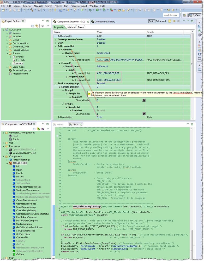

Hi brian,
Please try to use the SelectSampleGroup function.
Robin
