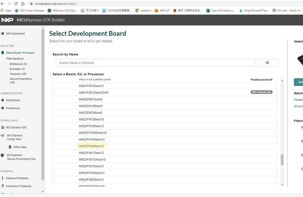

Or you can change to use MK22FN128VDC10, which already in the MCUXPresso and the SDK support list:
https://mcuxpresso.nxp.com/en/select
Wish it helps you!

jrivera_eizo
Thank you for all the helpful information @kerryzhou!
We were running into the same issues about not finding a compatible SDK for MCUXpresso after @myke_predko suggested giving it a look. I'll talk to my team and discuss which direction to move in and I appreciate all the suggestions your provided.
