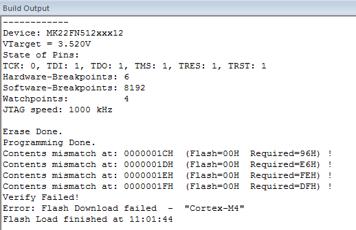

When I build a project, it's fine.
When I flash the target, there is the problem.
I assume flash writing fine because chip running as normal. (GPIO, UART, etc. works fine.)
But when chip verification, it prints out like this in build log
I already heard there is some region in Flash which cannot access.
But in my opinion, if I choose the right flash algorithm, verification also should be fine, isn't it?
Did I miss something? Are there any more options should I adjust?

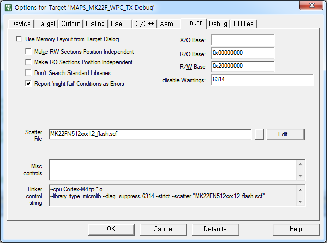

This is a strange problem. It seems only KEIL has this problem. I guess this may caused by some wrong project config. I think you can get around it. There are many examples build in keil in SDK package, for example SDK_2.2_TWR-K22F120M\boards\twrk22f120m\demo_apps\hello_world\mdk. If this example works fine in your system, you can migrate your source code to the project.

Hmm... Problem same. :smileysad:
I think project setting is not a problem.

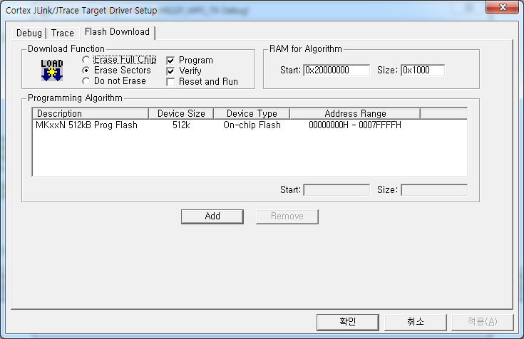

In SDK, there are no keil project setting with J-link. they are all pemicro.
So I'm not sure that problem show up when I change debugger setting.
Now I just do it without flash verify.
PS. When I tried flash writing in J-flash lite with HEX file, it doesn't works. That strange. :smileysad:
