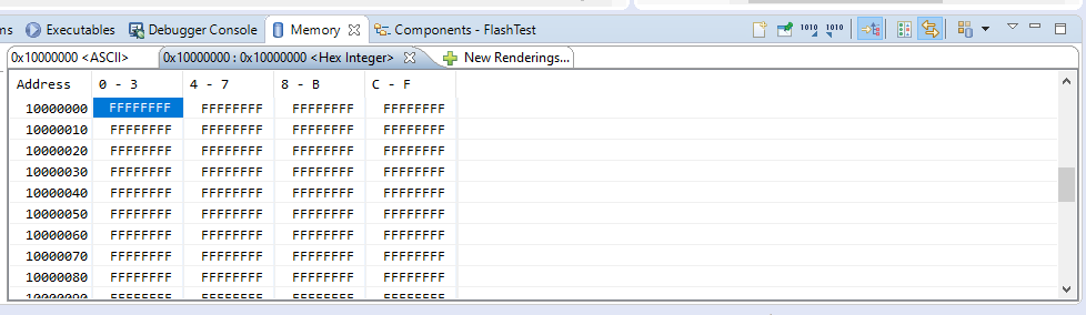

Hi,I tried to write and read data from eeprom(0x10000000 to 0x100000FF).But data writing is not happening properly.please have a look on the attached screenshot.Here i had tried to write 0x23 to 10000040
after write commandafter write commandbefore data writtingbefore data writting

Hi @pmathew96 ,
Please refer to this link. People pasted their code. You can refer to it.
https://community.nxp.com/t5/Kinetis-Microcontrollers/KEA-64-suspends-during-internal-EEPROM-erasing...
Please Note that The EEPROM supports only byte access.
Jing
4,308 Views
jingpan
Hi @pmathew96 ,
Read EEPROM data from 0x10000000 to 0x100000FF. You can read them as a normal flash. For example, data=(*(unsigned char*)0x10000000).
Jing

pmathew96
Hi,@jingpan
I found only option for read once(for reading the flash segment which can be programmed once).i didn't find the command for reading it,also didn't find the same on evk sample code
4,295 Views
jingpan
Hi @pmathew96 ,
yes, it seems there isn't such example.
