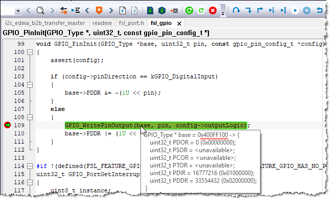

/*The code hard faults here when this function calls GPIO_WritePinOutput()
which write to the PCOR register*/
GPIO_PinInit(i2c0_sda_pin.bank, i2c0_sda_pin.pin, &gpio_output_default_low);‍‍‍‍‍‍‍‍‍‍‍‍‍‍‍‍‍‍‍‍‍‍‍‍‍‍

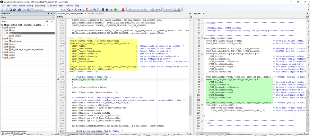

Robin_Shen
I try to reconfigure the SDA pin as GPIO output 0, the hard faults did not happen.(i2c_edma_b2b_transfer_master example ...\SDK_2.4.0_FRDM-K64F\boards\frdmk64f\driver_examples\i2c\edma_b2b_transfer\master\iar)
Please check if the base address which pass into GPIO_WritePinOutput() was correct or not.
Robin
