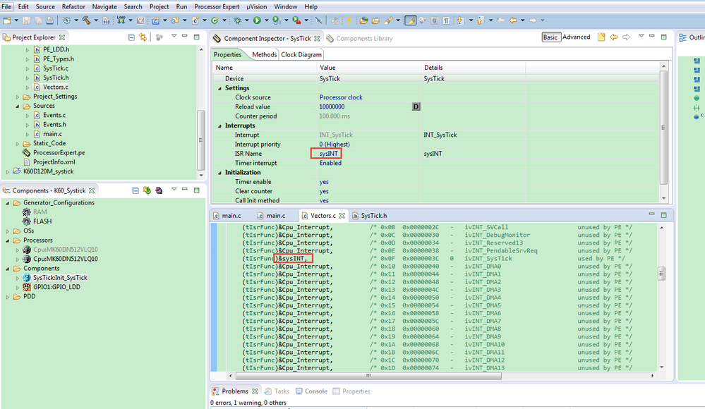

Now, i have a interrupt function to service the SysTick but i can not generate the appropriate vector table for SysTick even though the Vector.c has the hook for it:
(tIsrFunc)&Cpu_Interrupt, /* 0x0F 0x0000003C - ivINT_SysTick unused by PE */
Can you please help me on how to get PE to generate a vector table mapping in Vector.c and the call function in Event.c like the NMI, SV call, Int Pending?
i hate to go back to Vector.c to modify every time we happen to generate new code just in case we change some CPU setting.
Attachment is the screen shot on PE of CPU component where i can not find the option for systick. Should i invoke a HWTimer in order to have SysTick vector configured?

Hi Henry Nguyen,
   I have a K60 KDS PE project for Systick interrupt, please check the attachment.
   If you want to enable the systick interrupt, you need to add the according component, set the ISR Name and generate the code.
   If you don't want to change the vector.c at each time.
   You can modify the Vectors. __vect_table, all the interrupt you can write the name in the comment by yourself, then when you use the according interrupt, just named the according component ISR as the same name in the __vect_table. Because the module interrupt named is controlled by the according PE module, then if you want to give the name to all the interrupt, you need to modify the vector.c by yourself, then lock it.
   The ISR function can call it like this:
PE_ISR(sysINT)  // or other interrupt name in the __vect_table.
    // insert you own name.
Wish it helps you!
