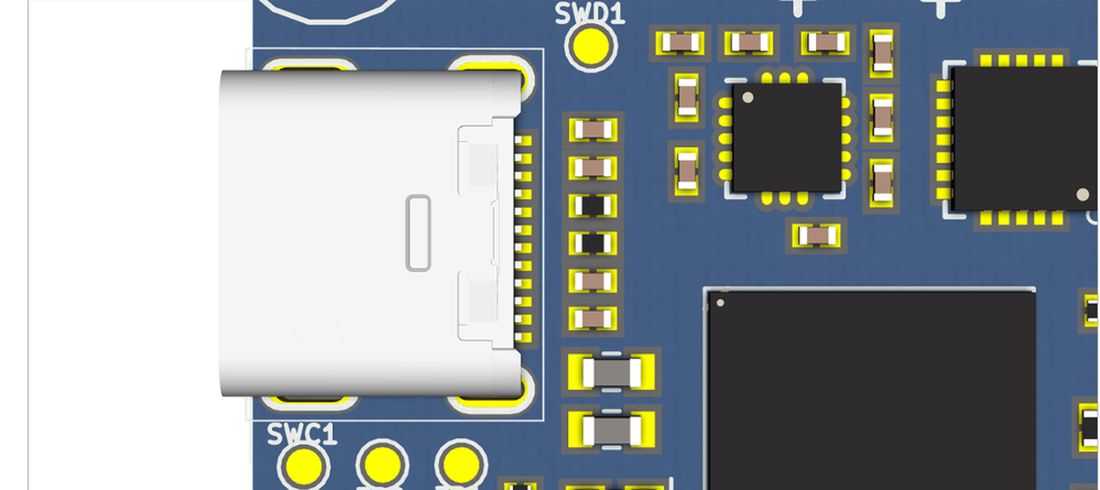

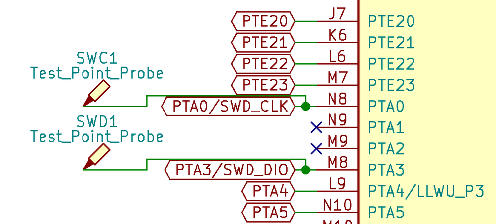

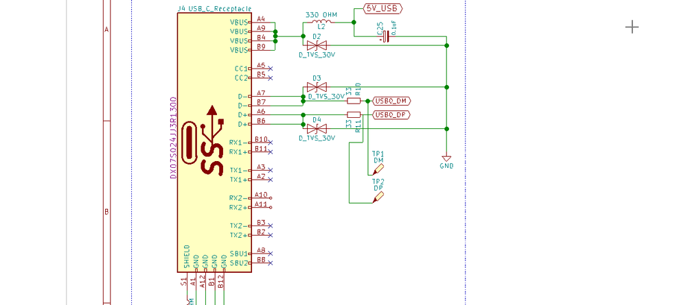

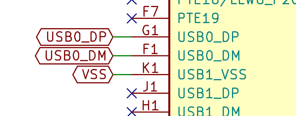

Then, like I have done in my designs is ok, I think.  MK28FN2M0AVMI15
So, I think, that I can update the application trought USB0_DM USB0_DP  with USB DFU and debugging/trace with the test points SWD1 SWDC1 with Cyclone or similar.

Besides what you had found, please also note that we provide K28 ROM bootloader, which supports USB FS HID bootloader.
I am not sure if you are using the NXP evaluation board, If you look at the FRDM-K28 board, you may notice that the USB port of FRDM-K28 can been used as downloading the demo program through blhost.
