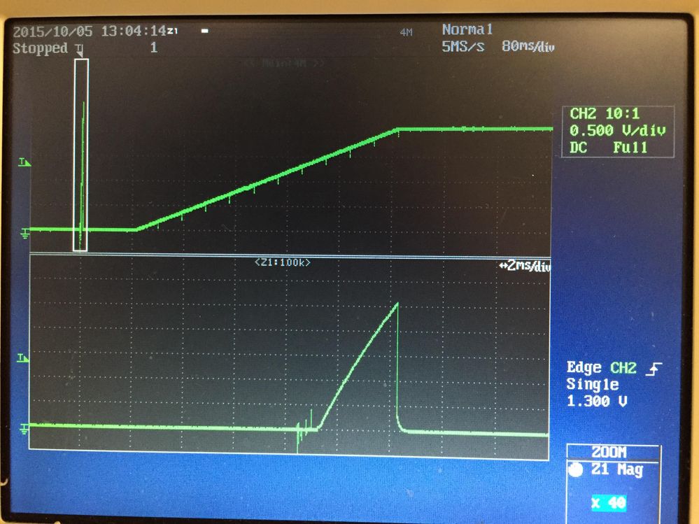

I would like to draw your attention to some details. In your figure, there is a small spike before DAC starts to output, which is highlighted in red circle in the pic below.

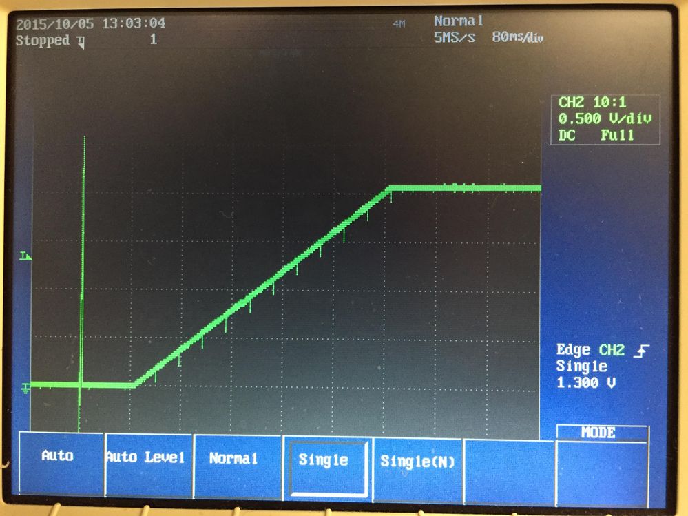

On my processor, I could also see this spike, but with higher amplitude, as shown below:
I zoom in the spike, and it shows as an increasing slope, and then drops down to zero.
The bandwidth of the scope in the figures above is 200 MHz. Since you also have the spike on your waveform, I assume it's not my measurement problem. I'm wondering what causes this voltage spike, and if there's any method to avoid it.

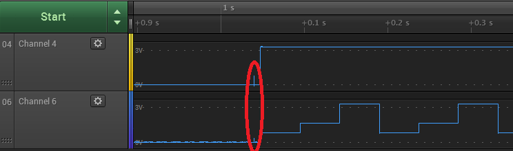

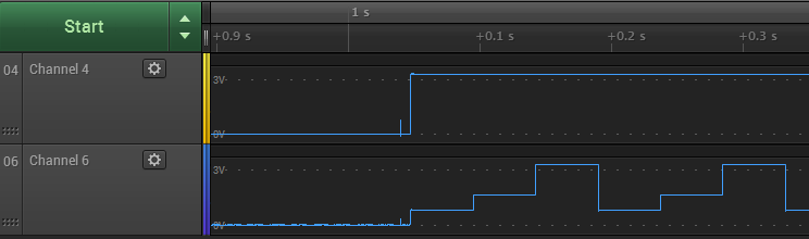

Jorge_Gonzalez
Hello marie lu:
I tried with a FRDM-K22 and I do not see this behavior. This is what I get (Power ON and then I write random values to DAC):
Could you attach your project?
