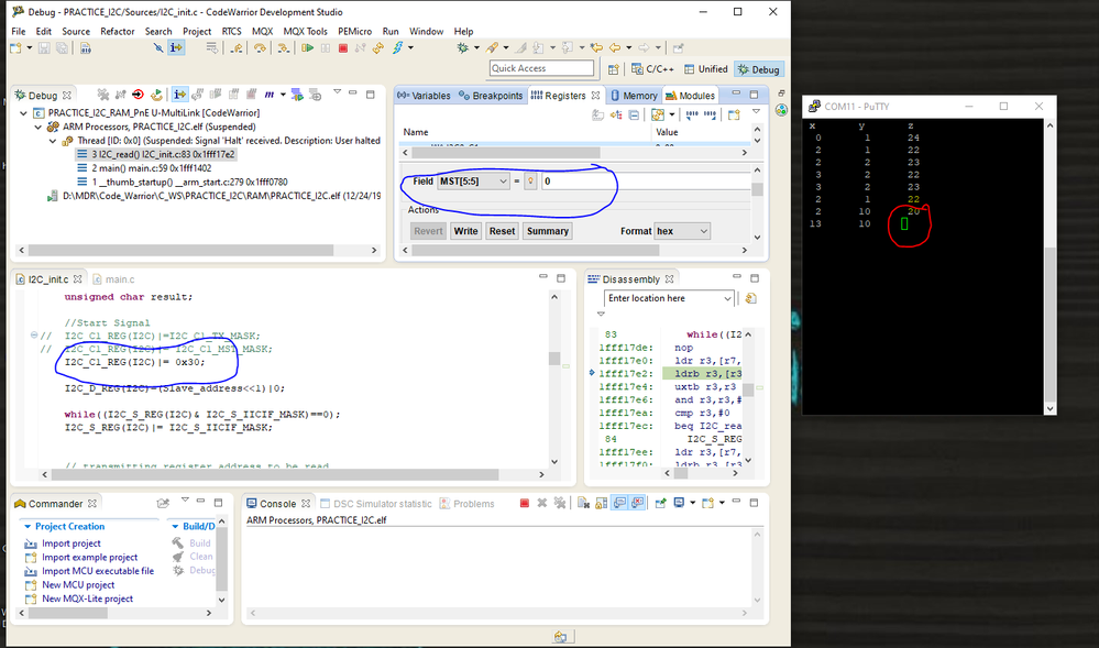

  I was interfacing the K60 microcontroller with the accelerometer MMA7660FC which is available on the tower board using I2C . I am configuring Microcontroller as master and MMA78451Q accelerometer as slave.
When I am transmitting in master mode the slave address is transmitting correctly by setting interrupt flag in status register but when i transmit register address it is not transmitting it is hanging there only when is check interrupt flag in while loop. I am not getting whats the issue. Please help me out.
Iam using I2C baud of 100k. I am attaching my code please check it once

   Sir actually the problem is when i debug by using break points it is updating but once i run without break point is not working. When i check the status register the interrupt flag is not raising after sending the register address of the slave.
And one more thing when i configure accelerometer by writing to the register 07 to change to the active mode and starts reading the accelerometer it is not giving the output. whether i need any configurations to update.

You would be better to try the latest library in our website "https://mcuxpresso.nxp.com/en/select ". And using debugger to debug the communication protocol will influence the timing sequence of i2c. Use logic analyzer or  oscilloscope to watch wave.

I have taken screenshot let you see this. After giving values for few iterations the master switches to the slave automatically.i2c_error1.PNG
