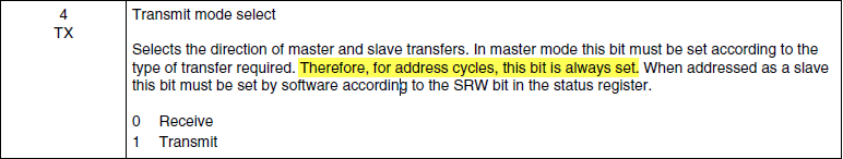

Hello Ankur Chauhan:
In the Slave Address cycle the TX bit must always be '1'. This is specified in the Reference Manual:
Maybe you are confused by the "Read/Write" mode of the I2C protocol specification. Although both things are related when developing the code, the TX bit is inherent to the I2C module and indicates the transfer direction, while the "Read[1]/Write[0]" mode is specified by the least significant bit in the first byte of the I2C frame (address byte).
I hope it is clear.
Regards!,
Jorge Gonzalez
