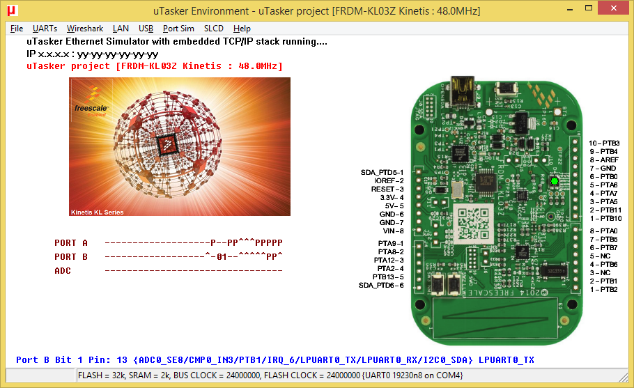

You can get some more real-word advice on the clocking at http://www.utasker.com/kinetis/MCG.html
For the KL03 you can clock directly from the IRC48M for 48MHz or from the LIRC for 2MHz or 8MHz.
If you were to use the uTasker project these are the settings to choose all options (with 48MHz valid):

Below is the uTasker KL03 simulator confirming the clock speeds obtained:
