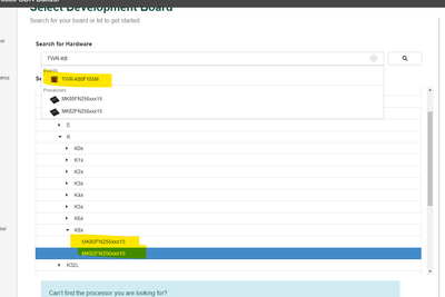

Thiru_S
Hi Raul,
Thank you for the info.
"TWR-K81F150M" SDK is not present in the SDK builder, your link shows like below,
Please advise.
Thank you.
Thiru.

RaRo
Hello @Thiru_S,
Could you please go to Support | NXP Semiconductors and request an NDA to obtain the K81's SDK?
Best regards, Raul.
