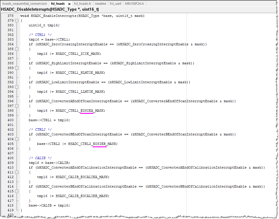

You may need to add below codes:
void HSADC0_CCA_IRQHandler(void)
    HSADC_ClearStatusFlags(DEMO_HSADC_BASEADDR, kHSADC_ConverterAEndOfScanFlag);
EnableIRQ(HSADC0_CCA_IRQn);
HSADC_EnableInterrupts(DEMO_HSADC_BASEADDR, kHSADC_ConverterAEndOfScanInterruptEnable);

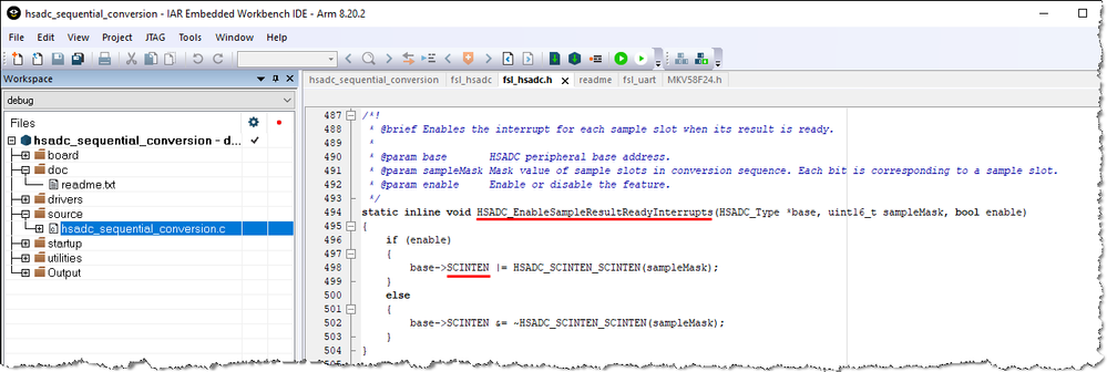

1) Then I add
" HSADC_EnableSampleResultReadyInterrupts(INETVU_HSADC0_BASEADDR, 0x0400, true);" for the last channel(11)
and it works.
2) If I disable "HSADC_EnableInterrupts(DEMO_HSADC_BASEADDR, SADC_ConverterAEndOfScanInterruptEnable);"
and it works as well...
I do not know if I use "scanEndInterrupt" in sequence scan? And what is your suggestion?

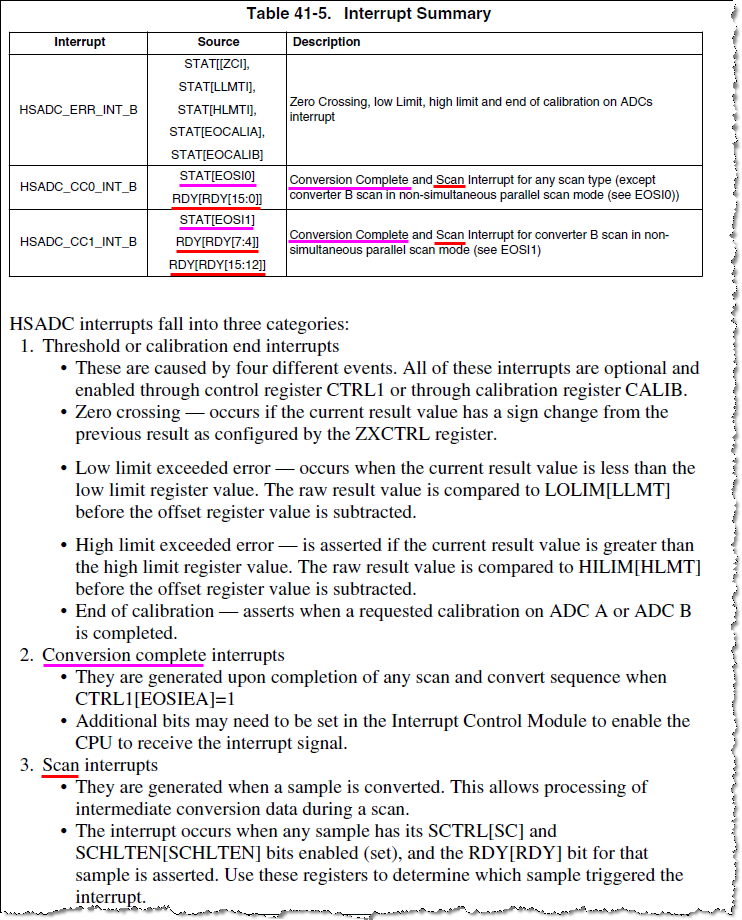

The Conversion complete interrupts and Scan interrupts are different. Please read "41.6 Interrupts" in KV5XP144M240RM.
HSADC_EnableInterrupts can be used to enable Conversion complete interrupts.
HSADC_EnableSampleResultReadyInterrupts is used to enable Scan interrupts.
Robin

If I enable "HSADC_EnableInterrupts(DEMO_HSADC_BASEADDR, SADC_ConverterAEndOfScanInterruptEnable);",
the interrupt will not be generated. But I can see there is the scan end status if I check the state register.
Only way to generate the interrupt is enable any sample interrupt by using " HSADC_EnableSampleResultReadyInterrupts(INETVU_HSADC0_BASEADDR, 0x0400, true);"
I do not know why the scan end interrupt does not work in this case?
