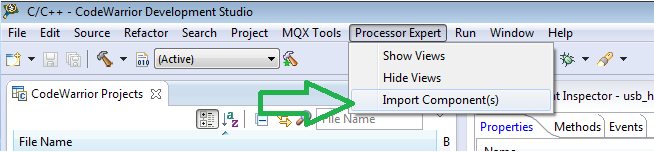

  • Open CodeWarrior and select Import Components in the Processor Expert button in menu bar.

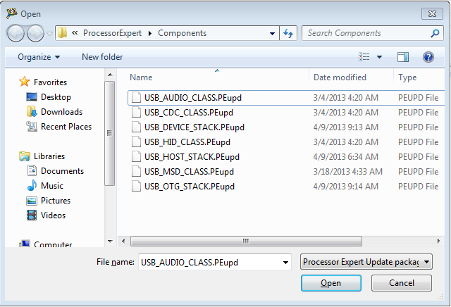

  • An Open windows will pop up, there you need to go to the path: <install folder>\Freescale USB Stack v4.1.1\ProcessorExpert\Components. To have the complete components and support for the USB module add each PEupd file repeating this step.

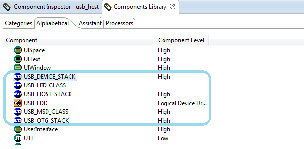

  • Close CodeWarrior and open it again to ensure correct installation of the components.
  • Check that the new components are available in the Components Library.
