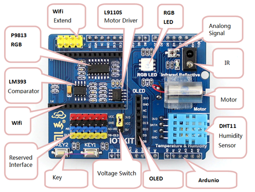

There is a popular WIFI platform called “GoKit” in China. This testing kit can be use to do some customized application. Not only WIFI communication, kit also support other functions. You can find interfaces listed as below.
GoKit Interfaces:

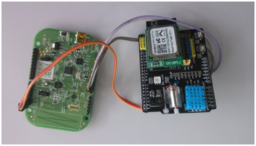

I try to use FRDM-KL02 to communicate with this kit to do a WIFI communication application. Board connection as below.

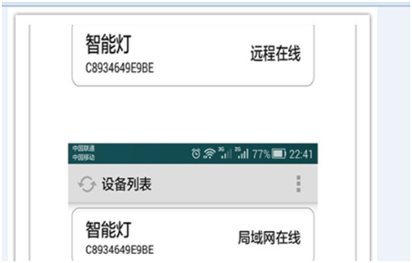

  3. Short press Key2 to go into configuration mode, wait until RED led flash on WIFI module.
  4. Open demo APP, select “adding device”, input SSID password.
  5. Waiting for configuration finish.
