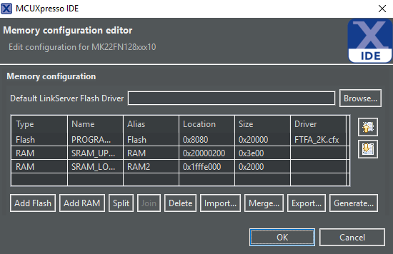

Back to my main application, i've read some posts and looked through Loader.h and it seems like it uses 32*1024 +80 which gives 0x8080 start point of my application.
I've made some changes ( correct me if they're wrong) . Added 2 lines in main code:
SCB -> VTOR = 0x20000000;
memcpy((uint32_t*)0x20000000,(uint32_t*)0x00008080,0x200);
And changed memory as shown on the picture below:
13,670 Views

The standard configuration is for the application to be linked to start at 0x8080. You can reduce this to 0x4080 etc. if you like (the 0x8080 allows various loaders to be used compatibly, even with Ethernet Webserver, Modbus and AES256 encryption, but you are free to change it to make the most use of the chip's resources).
The uTasker code is much more efficient than the example code and Kboot etc. so typically will be half the size and, if you study the source, much easier to understand and better commented (it can also be fully simulate in Visual Studio for code reviews and such).
What you have done with application linking and copying the vectors to the SRAM looks good but usually one locates it at 0x1fffe000 (and you need to ensure that this is not used by variables, which can be done by setting the linker script used by the application to starts its RAM at 0x1fffe200)

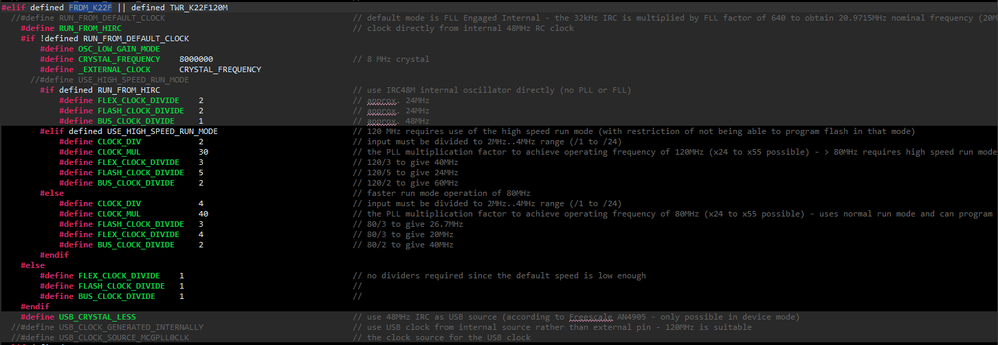

I'm still wondering if external crystal is not needed at all, because i can see some  defines for crystal so maybe it hangs somewhere in osc initialization?
#define OSC_LOW_GAIN_MODE
#define CRYSTAL_FREQUENCY 8000000 // 8 MHz crystal
#define _EXTERNAL_CLOCK CRYSTAL_FREQUENCY
I'm attaching 2 files, modified by me, could u please take a look at them and tell me if everything is ok?

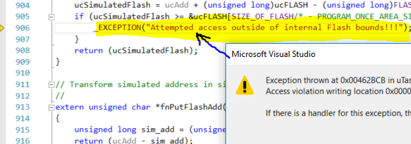

If you open the project in Visual Studio and run the simulator it immediately shows you the problem:
#define UTASKER_APP_START     (32 * 1024)   // application starts at this address
#define UTASKER_APP_END       (unsigned char *)(UTASKER_APP_START + (128 * 1024))
Since your chip has 128k of flash the application range is too large. What is happening is that there is a check at startup to see whether this range is blank and that crashes when checking beyond the end of flash.
The reason why you didn't see this when you had non-blank flash is because the check already quit since it had already found non-blank content - meaning it don't have to check so far and find it crashed.
Since you have RUN_FROM_HIRC enabled it overwrites the crystal settings (if you look carefully you should find these defines are not active and are displayed grayed out by the editor).
Therefore it will be Ok if you change the application size to
#define UTASKER_APP_END           (unsigned char *)(UTASKER_APP_START + (96 * 1024))
for example.
Or
#define UTASKER_APP_END           (unsigned char *)(SIZE_OF_FLASH - UTASKER_APP_START)
will work if you automatically want to use all remaining flash (although often one keeps an area for saving parameters to that is preserved across firmware uploads).

I'm not sure if you're looking at uTaskerSerialBoot because even if i got  #define RUN_FROM_HIRC , OSC defines are not grayed(blacked in dark theme) which is shown on the pic below.

My mistake about the oscillator defines not being grayed out, they aren't. But they are NOT used since RUN_FROM_HIRC has priority.
